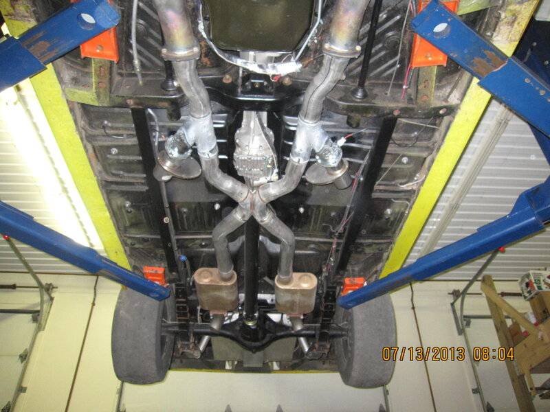

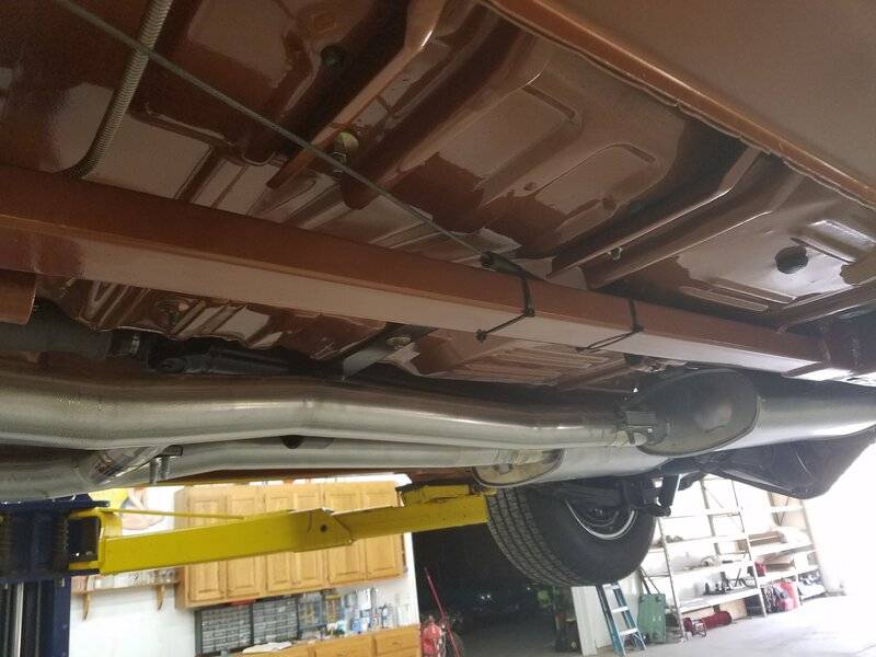

I bought 20' of 2" square tube and used it to do my 65 & 66 Belvederes.

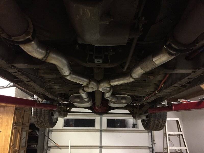

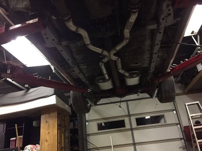

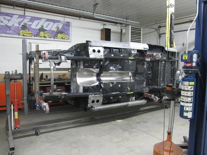

I cut 14 ga into 3 sides at work and cut/formed to the floor pan.
Took me most of a day, but the car is noticeably stiffer.

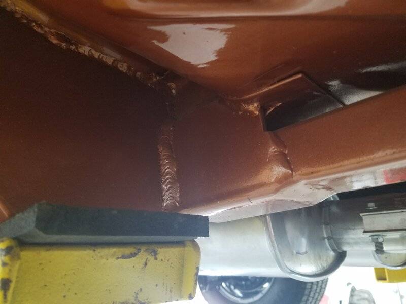

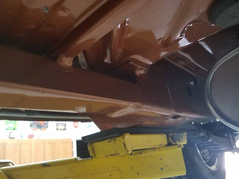

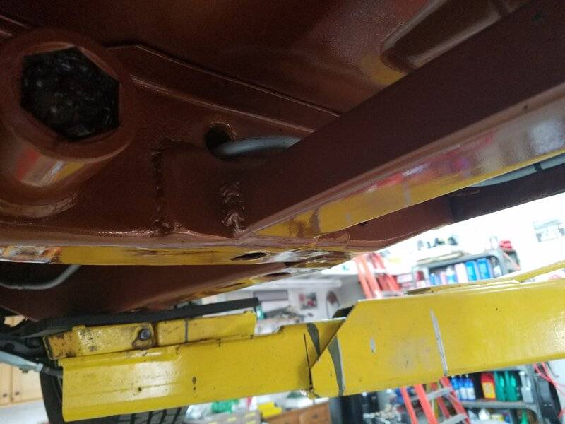

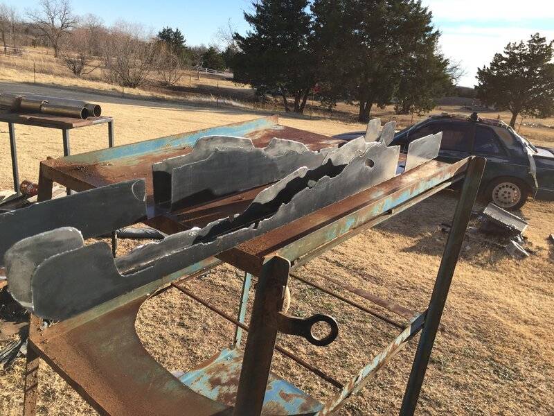

I use 1.5" x 2.5" .125" thick tube, a flat piece on the front and have a u channel bent for the back. On the back I cut the tubing at an angle to match the rear frame, then cover that joint up with the u channel.
