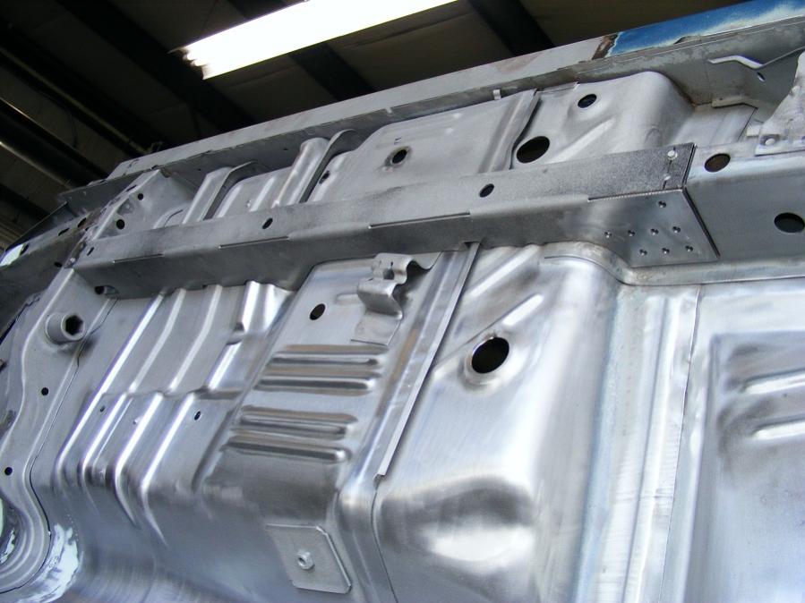

I just put these in my 68 GTX and spent about two hours each making them fit perfect before mig welding them in. They are the best thing going, and when done, they look "Factory". I drilled some holes and plug-welded them also. Just under $200.00 with shipping and you can't beat them.
Those contoured connectors look awesome and reasonably trouble free from what I've heard. Our altered has a totally one-off floor, therefore we needed something custom. I used 2x2 box tubing and welded a plate to my front cross member for added strength. In the rear I notched a section out of the rear sub-frame and slip fit the tubing in welded on three sides and plug welded. Of course we did run them through the floor and welded material on both sides. I'm pretty sure it will get the job done.

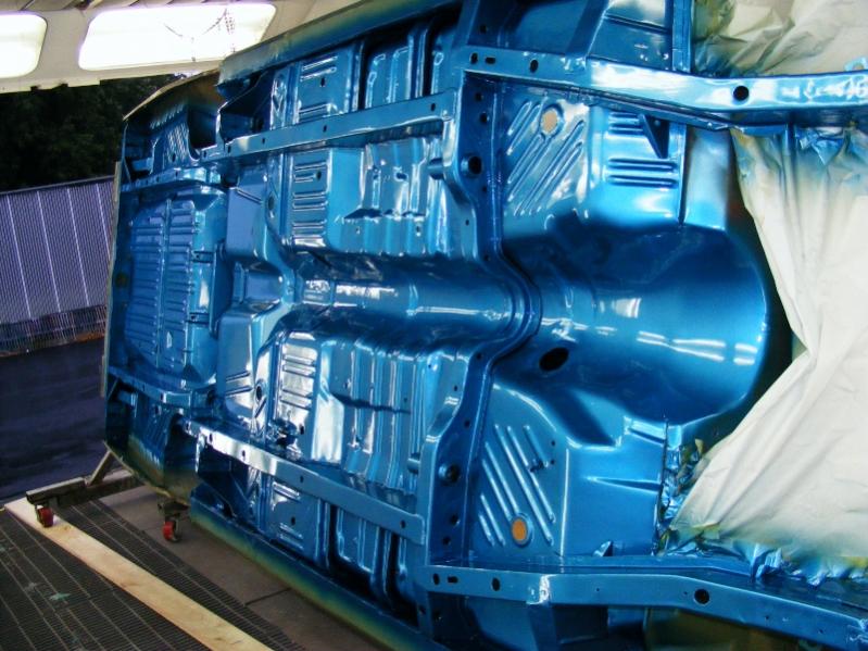

Yes, I did MIG them in with .030 wire, and painted the undercarriage with QQ1 DuPont IMRON. Now THAT looks nice. Lotsa work, but worth it. Now for the rest!!! Good luck!
Sorry, Don't have the hang of these pic's yet!
That looks great, just got to get a rotisserie. Nice!!

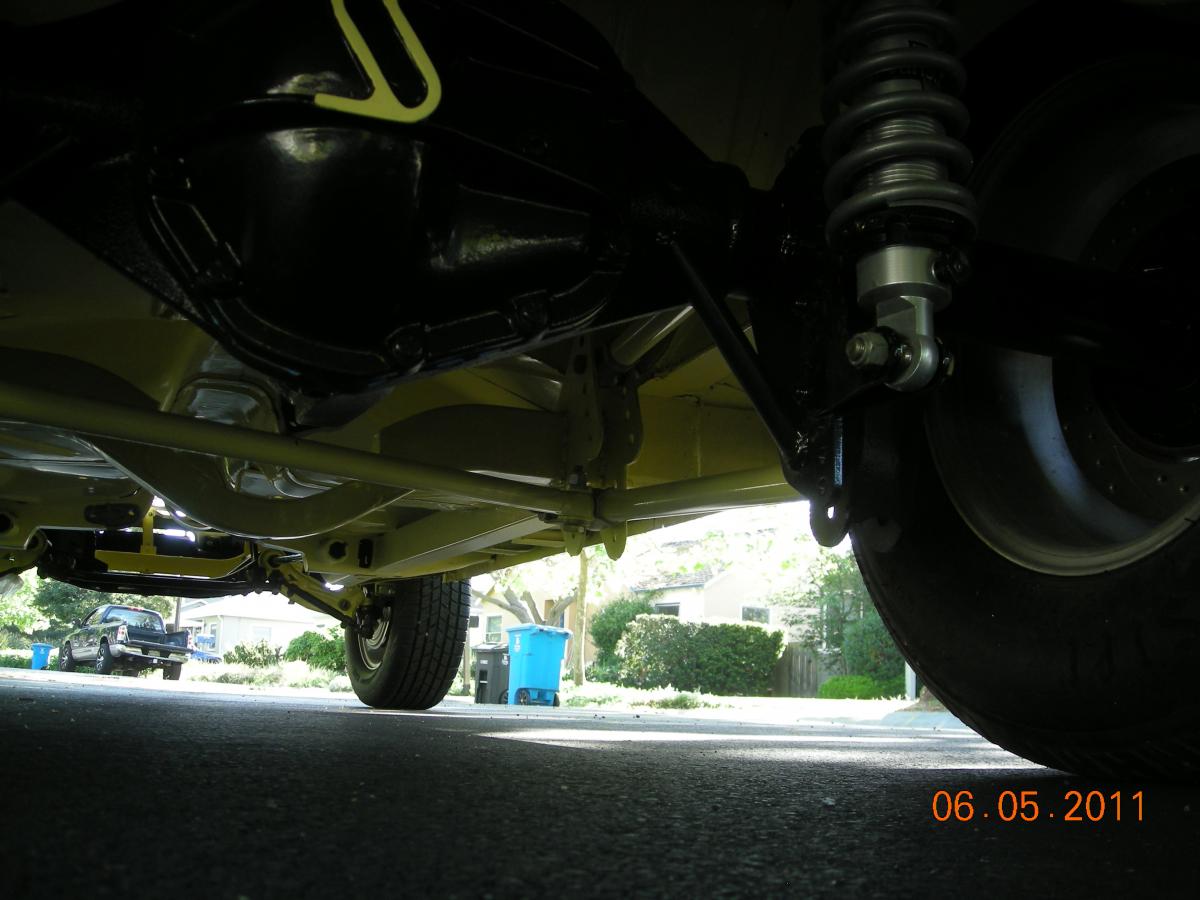

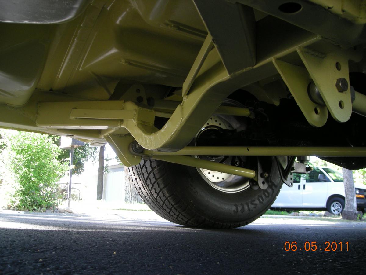

Here is something a little creative in case you want to go all the way with 4-Link while you are down there !

(It's on a rotiserre as well! gotta love em'!) But your pic of the underside fully painted with those connectors it looks factory!!!! I had a set of old MP connectors on a 71 Challenger and did not like them because you could see them under the car when you stood back and looked at it!
