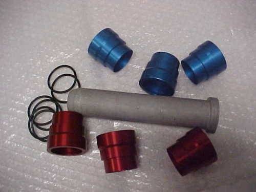

Mine does the same on a couple tubes & i even have the milodon seal inserts in the heads just nature of the beast. Check the bottom of your tubes to make sure there not cracked & get rid of the spark plug washers.

These inserts are on ebay for 75.00

I also have the Miodon bottom seal and still get some oil in there.Gotta pull the plugs REAL fast to read them!
I had them on my racecar also, they didn`t work worth a flip. if u got good tubes, or new ones, don`t use washers on ur plugs. that`ll help for a while. we ended up just putting up w/ it. (14 YRS.) didn`t have any miss fire tho.
