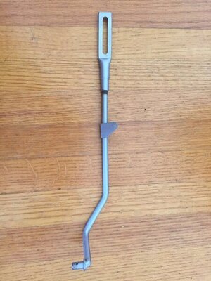

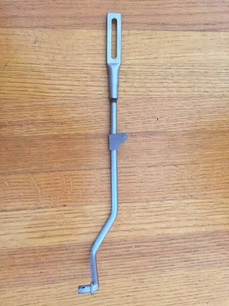

Yes I saw it, thank you for that. it explains a lot. I just went out and checked my linkage and it seems like its working as they explain on the video. One thing I noticed is that is still have the original rod which connects to the carburetor stud. Originally my car had a 2 barrel carburetor and I changed to an edelbrock 4 barrel. I did get the correct bracket that mounts to the intake which allows me to connect the throttle cable. However, I never thought about changing the rod, which not that I look at it, mounts at an angle. It should be like the once on the picture below. Any suggestions where I can find one?
Check on ebay or post a WTB ad in the classifieds here. I'm sure someone has one.

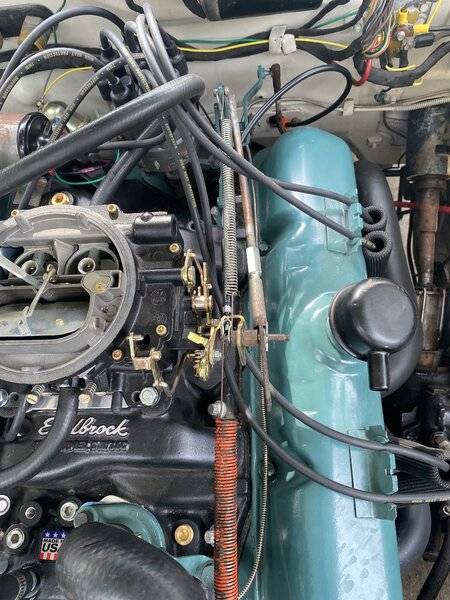

I have those two items installed already as shown on the picture. Purchased them from Summit. My concern is that the rod sits at an angle as viewed from above. I have been driving the car more frequently and it seems ok. I would just like to get the correct rod that has the bend to align it properly.

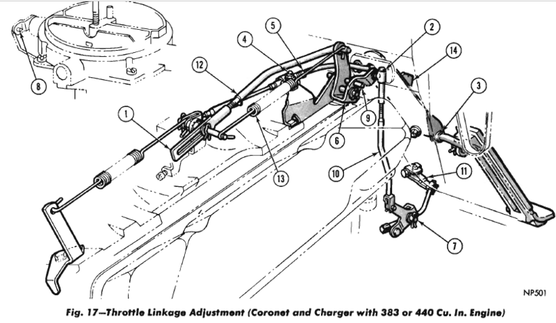

Compare your setup to factory. Notice how your rod (12) is installed in the bellcrank.
