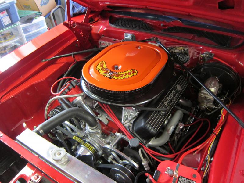

I have Hedman HTC Hedders on my 73 Roadrunner with 440 stroked to 500 and also use 440 Source Stealth Heads. Everything was just bolt in with no clearance issues. They were pollished at one timebut i made the mistake of using them while breaking in the Motor so they got cooked. That was 3 years ago and still no rust so i left them as is.

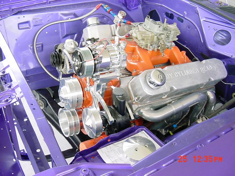

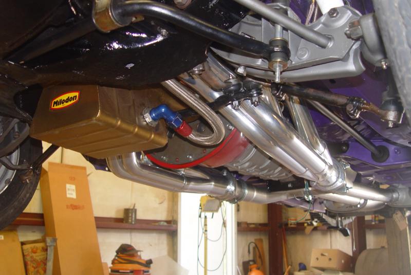

Here are a few pictures that may help you decide. This set of headers are the ceramic coated TTI's. They are installed in a '70 Challenger with a Stroker 440, so the engine compartment and front suspension / K frame should be the same on your car. This engine has Indy aluminum heads so we had to get the appropriate special header, because the exhaust ports were raised on the Indy heads. I installed a mini starter, and the plugs are not too hard to get to either.

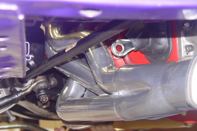

These pictures also show you how they fit if you run a Lakewood bell housing. I had to grind a little off one of the bell housing tabs on the passenger side for additional clearance. I also had to reroute the braided steel swinging external oil pickup line.
If you are running a stock transmission, either automatic or standard, I don't think you will have any problems. The last tube on the driver side has a slip on flange, so that tube can come out (without having to remove the whole header) and allow you easy access to the starter.
This set has 2 1/8" stepped tubes and has the 3 inch collector. I think the newer production ones have a 3.5 " collector.
They are a GREAT fitting set of headers. Expensive, but you get what you pay for.
Hope this helps.

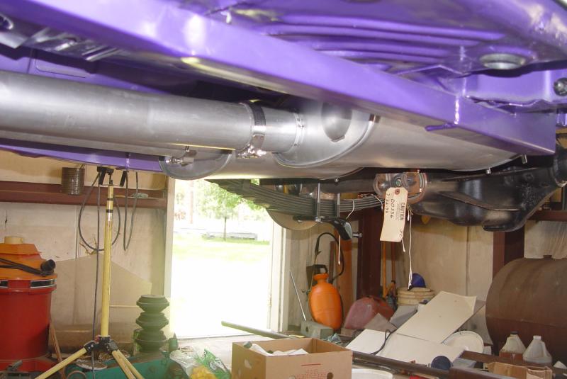

The last picture shows the ground clearance, which can become a problem when running large diameter exhaust systems. This car has 3 inch pipes all the way out the back with no fit problems at all.
Hope this helps.
What is the model number of the TTI? Very much appreciate the photos. BTW, very clean and neat job.
