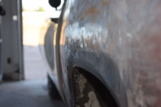

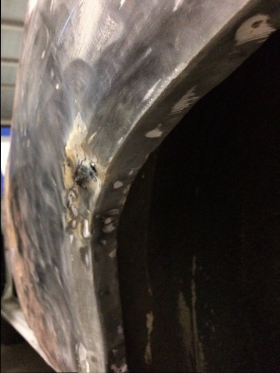

After stripping the rear quarter panels on my new '68 Coronet I found a 1970's fender bender repair. This repair had a lot of bondo and a few brazes from the era. The area between the wheel well and the bolt hole to the left (this is a 500 so it has the chrome trim around the recessed areas of the panel) is about 1/4" low. I think it is because the area right next to the wheel is still caved in putting pressure back into that area causing it to "pop in". I think I need to draw that area out and get more angle to the lip where the well chrome goes.
It is REALLY hard to get to that area from behind through the inner quarter access and reach around to hit it with a hammer. What is the best thing to do with this damage? I would really like to minimize the filler. Oh and I tried to weld a nut to the lip and pull it with a slide hammer. It pulled the hole in the metal in the photo. That lip is VERY stiff.

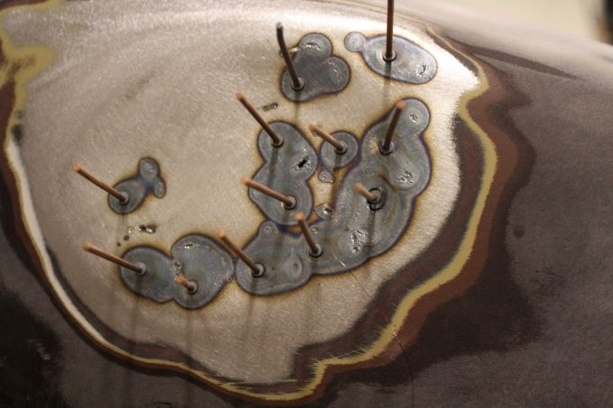

Jim, as you found out a localized pull isn't too helpful. But spread out over a larger area, such as a 3 or 4 inch J hook that reaches around the lip will work better with your slide hammer. You can also try blocking some wood behind it and jacking it out against the frame rail. And all those small dents can be pulled out by welding pins to the sheet metal and pulling them out, such as this gas tank example.
I don't think the inner finder needs to come out, they did a fair job at getting the basic shape back. It think it just needs the outer skin reshaped at the well lip, but like I said it is very very stiff due to the think steel and multiple tight angles. I think I may buy some metal shaping tools today. If I get the right dolly I may be able to get it in that area buy taking the quarter window out and reaching in from the window opening. I was going to buy a Harbor Freight stud welder but after watching a few videos with people struggling to get the studs to stick enough to pull a modern tin can car panel out I will save my 100 dollars. That seems to be a tool that you need to buy quality.

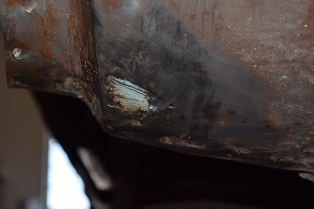

I am not sure I am that good at metal work. Spent a few hours with the right tools (stud welder, body hammers/dollies) and have it looking much better. It now matches my cardboard templates from the other side. The very bottom of the rocker in front the wheel does have a few small holes from rust (1/16" or so) at the corner so the panel is very solid but does have a few thin spots around the seams here and there.

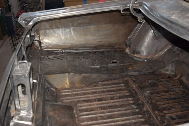

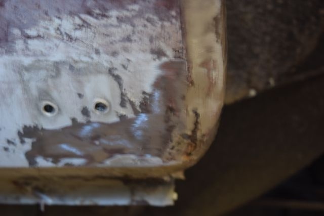

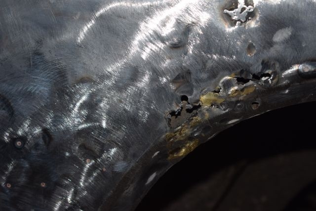

I am not sure I am qualified to say if this panel is in good shape or not. Below is a few spots on the right and left quarter panels that have rusted through in the corners. I finished stripping the trunk today as well so you can see the shape that is in..

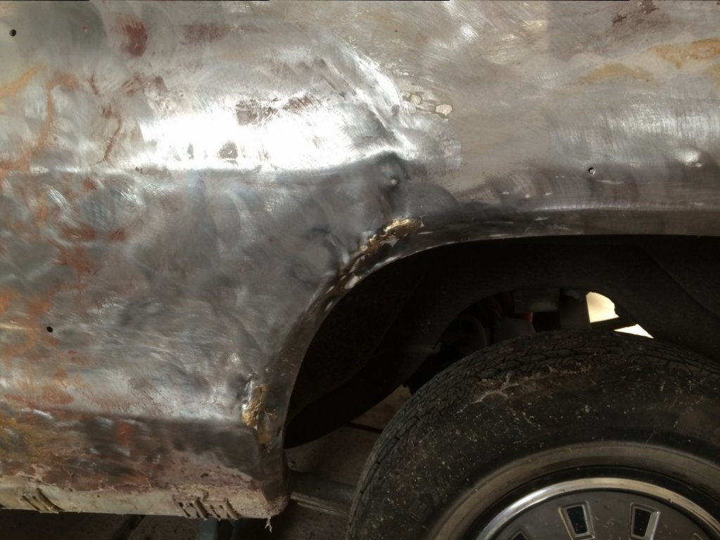

So here it he result. It is very, very close to being the correct shape based on my template and measurement with a T-Square from to concrete up to the wheel well. Also the trim fits nice and flush all the way around the opening.
Based on the rust that is making in roads to the panels I am on the fence as to what to do. Is it worth the effort cutting out the small areas where the metal is thin and butt welding in small patches or do I just use some fiberglass patches from behind since I need to fill it with filler anyway to get the final shape?
This is _much_ better than it was, you can actually see the lip for the wheel well all the way around now. I don't plan on this being a show car, just a very nice weekend driver.

Jim from what I see the body is pretty good , cant see the bottom ect but what you have shown is very repairable.
Most of these old b bodies that have set long you can toss a cat through the qts. :thumbsup:

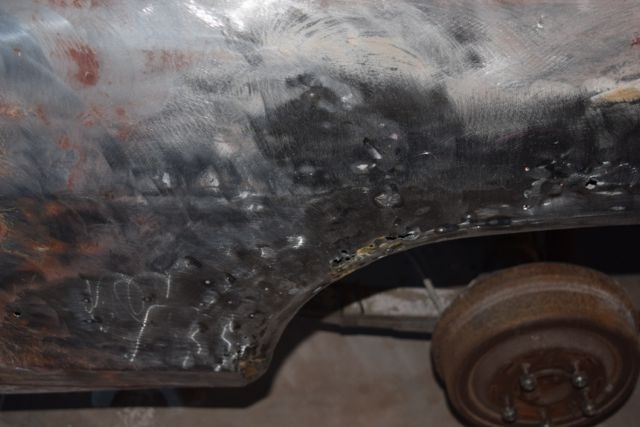

You guys guilted my into it and I am meeting you half way. I bought the cheap stud welder at harbor freight. Took a bit to get the knack of it but I can now use it well and the above is the first result. I have also cut out some of the really bad areas in the wheel lip and made patterns from the other side and have started to weld in small patches. I just finished replacing about 3" of the wheel well lip and will finish it up tomorrow. For not having a clue what the hell I am doing it is turning out better than expected (other than my welding of sheet metal needs infinitely more practice, I end up with more to grind off than is in the weld itself). I will post some photos of the finished result soon.

I am no where close to good enough to not have some filler. I am only closing the gaping holes and replacing a bit of the lip that was so crumpled it was not possible to straighten it (it had a big braze blob in the middle of it).
Replacing some of the lip is not a problem, sometimes you just can't save what's there.

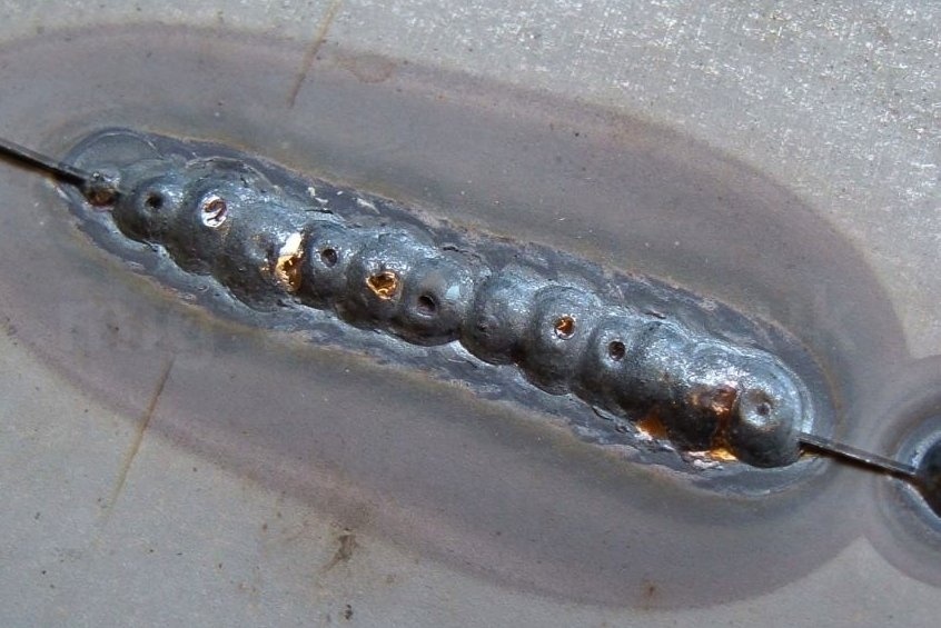

Just a tip on welding in new pieces, don't do it all at once. Start with little spot welds spaced out a couple of inches to avoid putting too much heat into the sheet metal and causing more warping. Once it's tacked in, continue with more spots in between and keep going until the whole joint is fused with individual spots. Running a long pass like this may look nice but will cause problems with all that heat.
Instead, you should look for something that looks like this when you're done.
(not my welding, I just used the pictures for examples).
