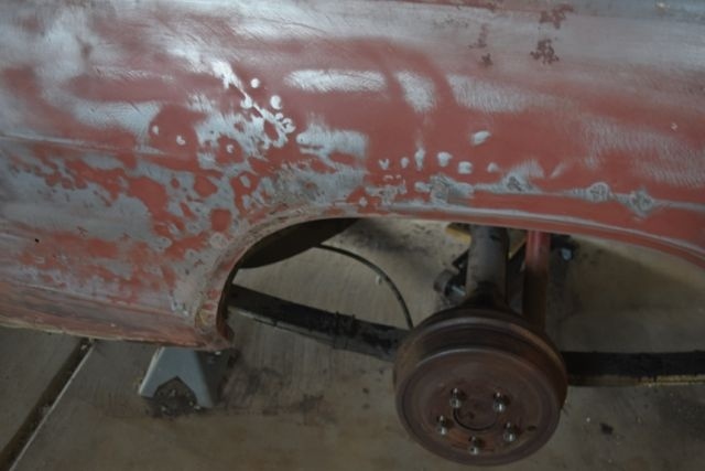

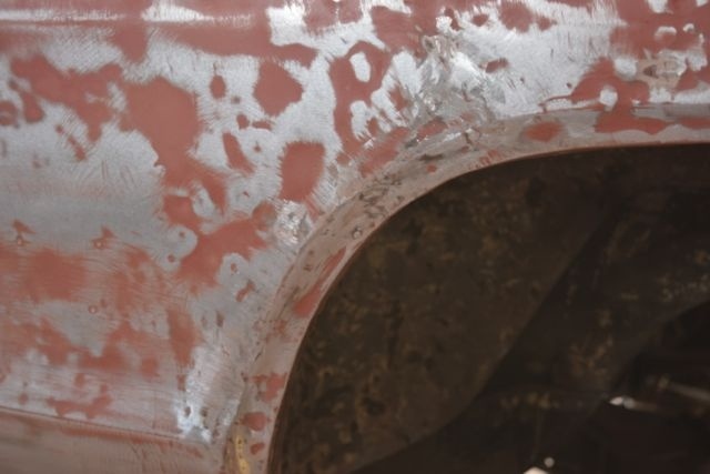

There are 4 pieces of fabricated metal in this area around the wheel well. The most complex is I had to rebuild the lower front corner with the compound curve. For my first time _ever_ doing something like this it came out better than expected. I don't think it will take much filler at all as I also worked out the high and low spots with the stud welder and body hammer.
I was getting ready to quit trying to weld that lower patch almost upside down. I finally realized I was not feeding the wire fast enough to "stuff" enough material into the weld instead of just arching and blowing holes in it…. Getting your welder tuned just right is key to not wanting to throw the damn thing out in the driveway and run over it.

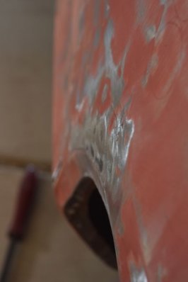

All I had left to do was do a simple patch on the right rear quarter corner. It always ends up being more work than you think. I cut out the rusted metal and gave up for today…

Many times there are tiny pin holes a guy just cant see if you are not able to get some light behind a panel. A skim coat of a fine / short strand fiber glass impregnated filler from evercoat ect is a good way to seal them so they are water tight.
That skim coat should then be sanded away leaving only the pin hole or holes filled.
We would much rather do that then take a chance on missing a pin hole and having a bubble ect pop up in a few months or years. I will admit to getting a pin hole or two when welding and with bifocals LOL the chance of missing one is pretty good.

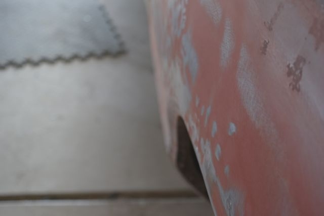

Tonight I planned on going out in the dark and put the flashlight in the quarter panel to see the pin holes. It was sort of like a constellation last night :) Yes the old eyes add another dimension to this project. Not sure if you are thinking there is still filler/primer on it. I did grind out all the braze and it was stripped clean. I have just been spraying on a few shots of primer to do a block sand to know where to pull or pound. I will strip it again before priming.
Yes I can easily access the back side of the panels where I welded and was contemplating how to seal any holes I missed. I will pick up some filler tomorrow.

Jim, {filler over top the epoxy} We never used the short chop strand glass filler to fill dings or dents, just to skim over the welded areas then DA off , Its just insurance.
Also go around all your welded areas with a wire wheel on a drill to get any and all carbon off before prime.
3M makes a nice brush applied seam sealer if you can get to the back side and clean it up good before brushing it on after your done welding. for any back side areas you cant reach just some plain old spray on under coat is good insurance also.

Oh and I did see a few points of light shining through my welds last night. Way less than I anticipated but still enough to take your advice. And no the gun did not come with a shrinking tip

skim a area larger than you need , many people try to just fill the low and end up re filling many times. don't do the entire panel but make sure to run your filler on past each area a few inchs that way you can feather edge it out. Concave areas are the hard ones and you need a round block that fits the concave, drag those areas out a bit more with the filler.

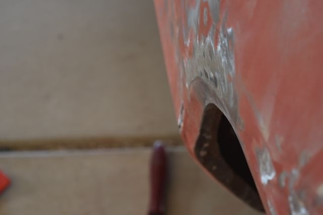

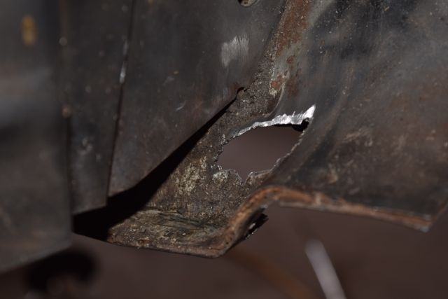

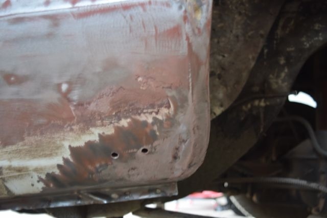

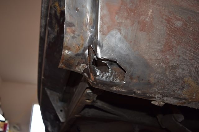

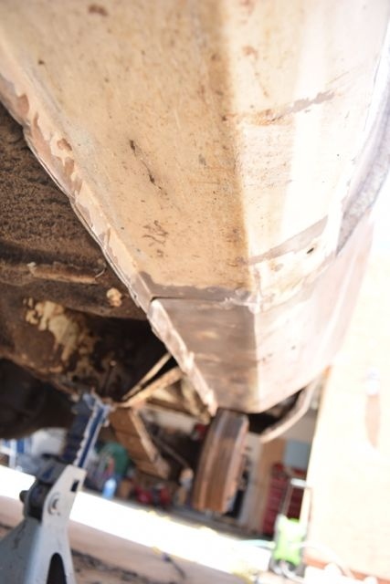

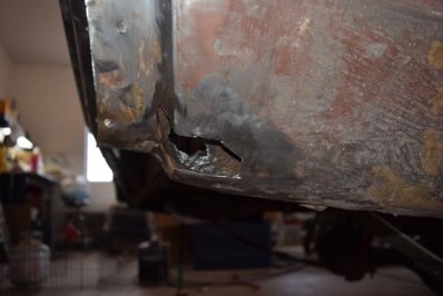

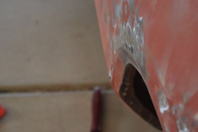

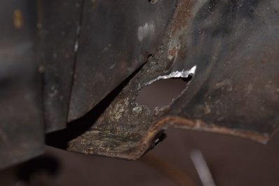

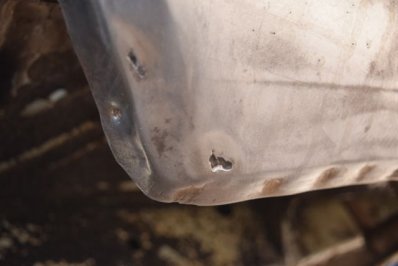

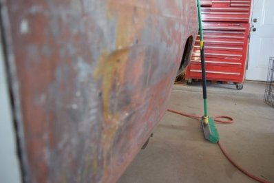

What is the right way to handle this. There are a few places bottom tips of the wheel wells (where they roll over to the horizontal body lines) that has enough rust in the seam to make the corner weak. It is not really enough to make a patch for.

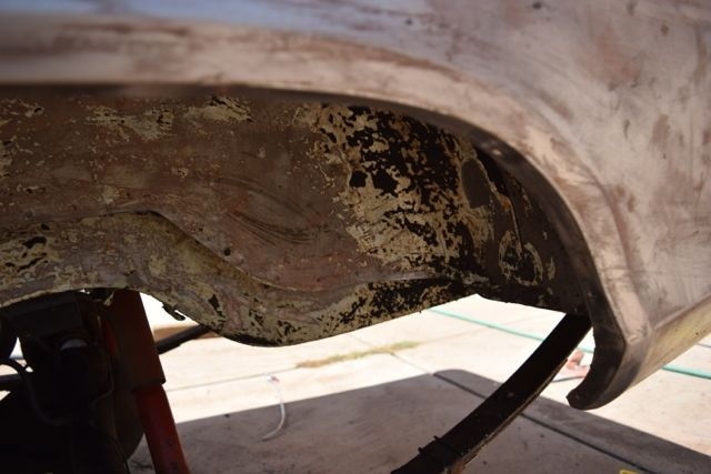

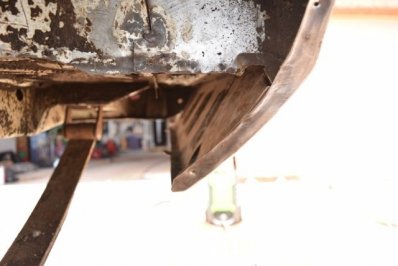

Here is a photo of what I am talking about. I hit it with a grinder with a very aggressive knot wire brush to dig out what was weak.

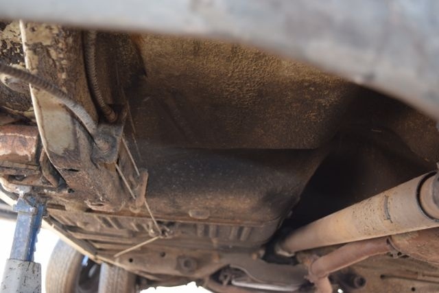

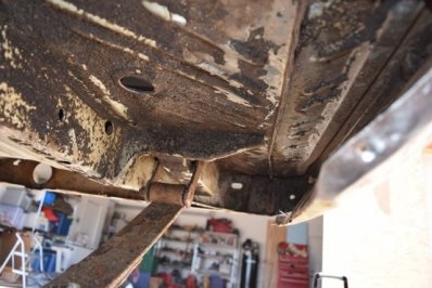

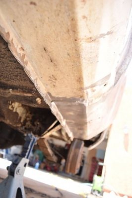

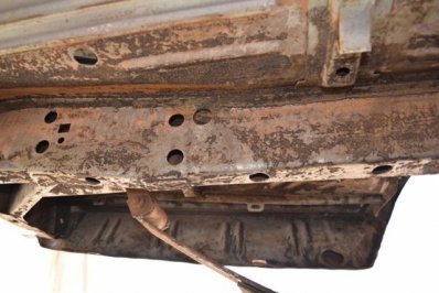

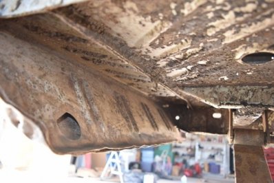

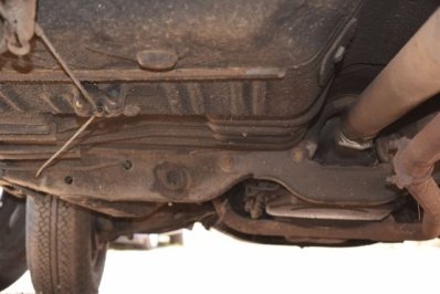

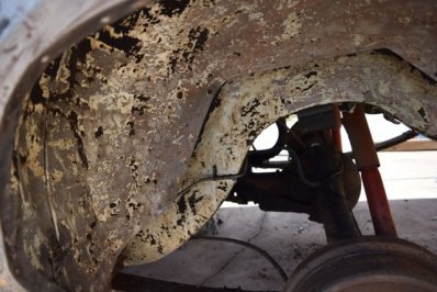

Here is what the underside looks like. The undercoating has turned to a weird powdery stuff. I have used one application of airplane stripper from the axle back so the dark splotches you see are the undercoating that is really still stuck.

The more I see of your car Jim the more solid it looks. Nice project.
Those spots you posted pics of if you look between them that dark area is going to come through in time.
All that needs to be cut out, just go along the body lines with a cut off wheel and make a L shape cut out, There will prob be a lot of crap / dirt hid behind it right at the bottom were things get tight. see what the back side of you cut out looks like, if your out of the rust your good to make a patch. Im not talking minor surface rust but scale and rot.
One way to get that hard undercoat off is with a putty knife and small hand held torch or heat gun, stinks like he// and is a nasty job but the end results are worth the trouble.
