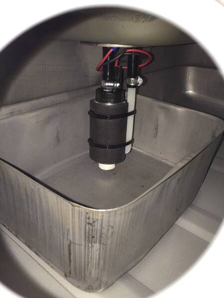

I like the looks how Aeromotive does the sump on their system to keep the suction covered. I think it could drop into a stock tank and not have any issues. The little tray on the tank’s system doesn’t look like it would keep the suction covered very well, but that is likely more of an issue with a FI system instead of a carb. I think the fuel delivery and dependability for that system your looking at is worlds apart better than the majority of mechanical fuel pumps.

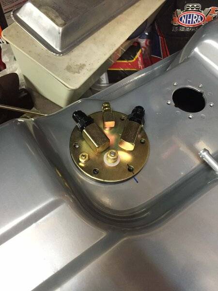

I opted for the new tank. I ordered direct from Tanks Inc., as our original needed replaced anyway, but summit has them as well.
Views of the tank outside. Pump on the left & Sender on the right were included.
Here is the inside view taken from the filler tube inlet and is, well, pretty cool!
