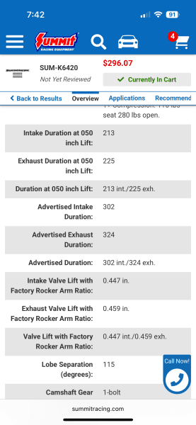

Has anyone run the Summit Racing K6420 383 magum “restoration” cam? Any issues with quality/lifter failures?

This is quite a small camshaft.
I’m looking to put my Bee’s original numbers matching 383 back to stock while it’s mothballed on the engine dolly. In the meantime, a date correct 383/451 is the motor of choice. It’s cam is a fairly mild (236 ish/.543 lift) solid with Ron (edit-Dwayne) Porter prepped Stealth heads. I agree a roller would be nice but not an option for this build.
