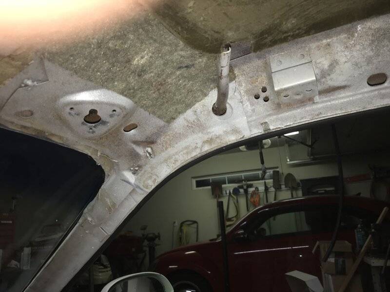

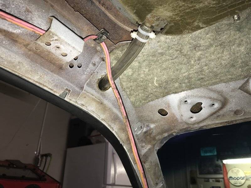

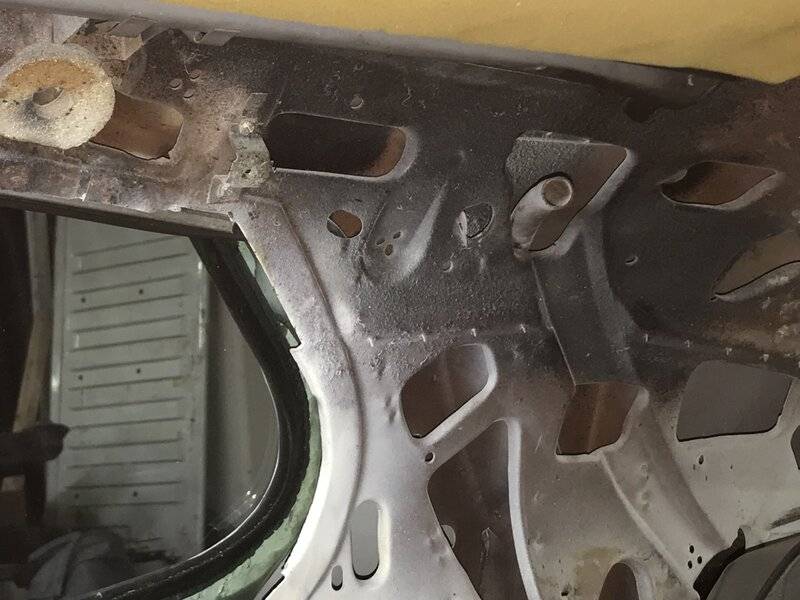

Don’t know about a 72 but here are some pics of my 73. All of mine simply dump into the rockers, just like the 1/4 windows allow water past their seals and into the rockers, brings a whole meaning to keeping your rocker panel drains cleaned out!
