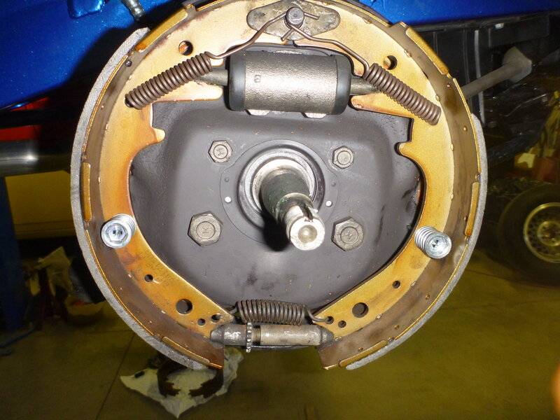

I have a 69 superbee with 11” front drums I am replacing. I noticed they didn’t come with self adjusters in the front. Is this normal? Both adjusters are right hand thread.
I don't think I would want self adjuster s on front !
I had a rear one go crazy one basically threw an anchor out hat to see what a front would do if one side has an issue!
Police and heavy duty 11" drums, manually adjusted front and rear.
Normal on both counts..
If they have the same thread Id mount one adjustment wheel to the front other toward the back. This way you only have remember which way to turn wheel because both go in same direction to tighten or loosen. I like to have tightening by turning wheel up to move shoes tighter to drum.

Yes that is correct. The self adjusters work with the parking break.
