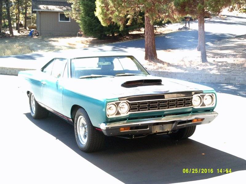

I installed a A12 hood lift off style & pins, lanyards
on my 68 RR
the core support on 68's b-bodies or fenders
didn't have the provisions for the pins you need to make a mount, drill holes
the rears were a bolt in deal replacing the hinges, mine was all from Year One

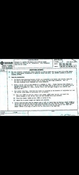

Thanks for the responses. I have tracked down the task instructions for the A12 hood see the attached JPG. The cars are mine including the Super Bee I am applying the A12 hood to.
Can't hardly see let alone read that...
& I'm on a PC with A 19" Screen
anyway good luck
a link to a post that has the technical bulletin posted and a copy of the bulletin for easier reading.
