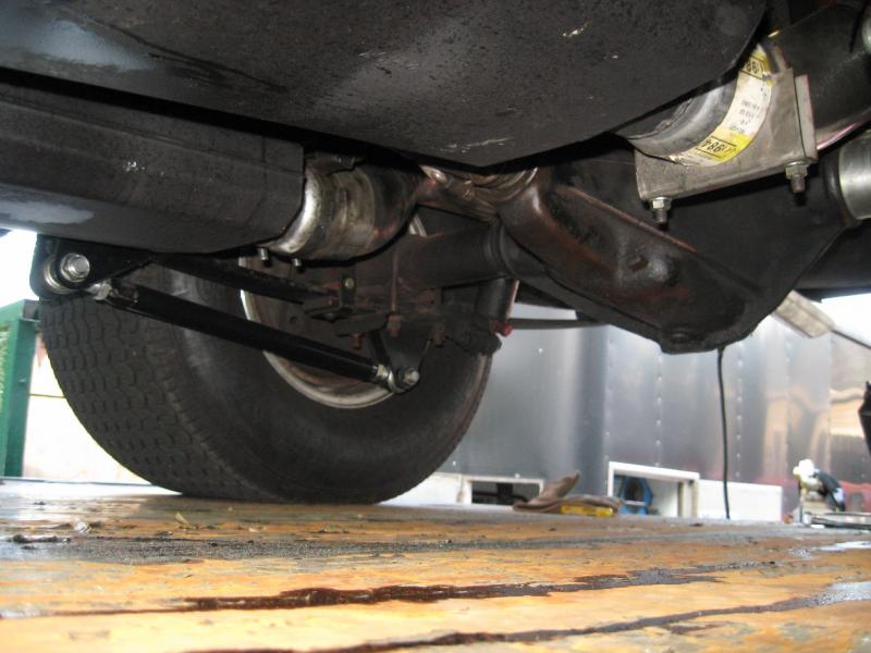

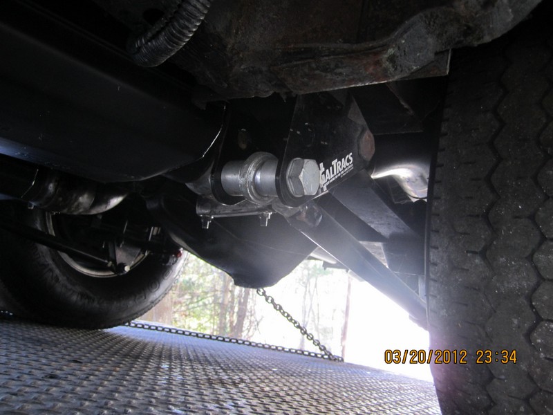

Stock front end,k frame & manual steering.Cal trac mono leaf springs,their bar & Ranco shocks.Dana rear,spool and a slightly wider tire:blob1:
