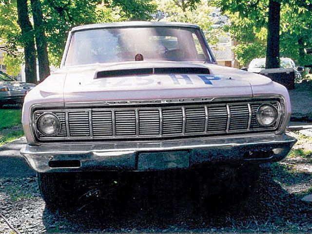

I believe they just used pieces from another grill to cover the headlight. That's why (if you look closely) those pieces don't fit properly

Yea as far as I have heard they just cut a section out of another grille and used it. Maybe e-mail Mosher's and ask them if there is any tricks. Ron
The real deal
If tow grilles were put together you sure cant see it on a real 64 Hemi
I can just barely see how they did it.........Nice work, and a mean look those boys got.

That is an UNtouched original. Owned by the son's of the original owner in NJ

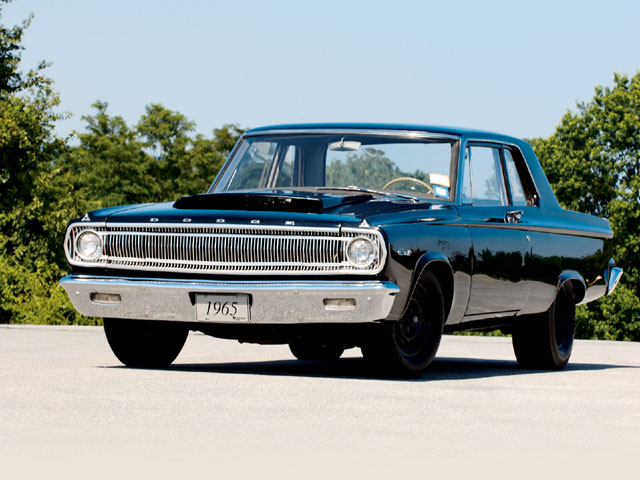

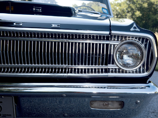

The 64 Plymouth S/S grille in the thread looks excellent, but the 1965 Dodge Coronet grille work's it a little different. Do you have pictures as guide....I would assume you do.

Call King of Trim in or look up their website. They did Bill Goldbergs grill for his 65 s/s Cornet clone.
@62BT409: I don't have pictures for guidance.

i have a 64 savoy and i made a s/s grill for it and as far as im conserd it looks as good as any factory gill . chry. had so many guys makeing them no two look alike. it takes two grills to do it i took so many pic. of org.s/s grills and beleve me some wer pretty shaby if you look it the one in the pic. you can see were it is put together. id like to sell my 64 grill or make one to sell i have another grill to do so. hell if you want ill make one for you
65 Dodge
I knew I had it some ware, getting old sucks !
