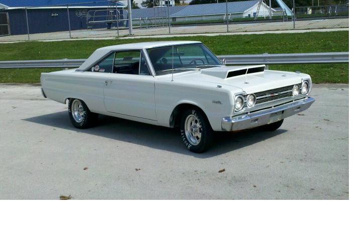

Made a **** ton of difference on my ride!
Mine was a 100% complete factory original car when I picked it up. Mine was from an estate sale in Texas and the daughter in law was in charge of selling the Ol mans stuff while he lived in a nursing home. I even have the paperwork from the dealership when he checked the options sheet and the down payment canceled check.... Lots of original dealership documents, Certi-Card...... everything.... Even all of the registration papers for every year it was plated....
The above picture is of the car when I drove it off the trailer into my driveway three summers ago.
