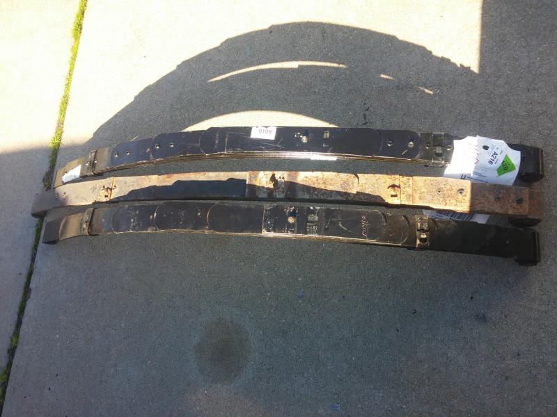

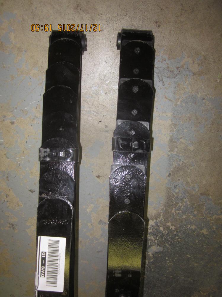

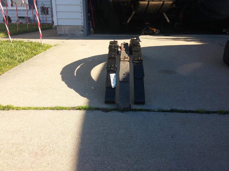

Here you go. 456 and 457 SS spring next to a stock 68 coronet spring .....
