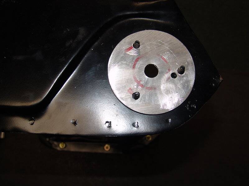

Anyone have an extra set of Superbird headlight pivot adjusters and bushings like pictured? Thanks

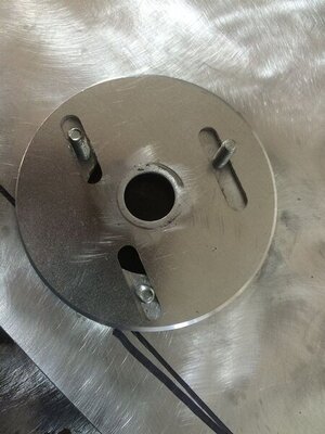

If you still have it could you scan it and send me a copy? It wold sure speed up the progress. Also what did you use for the bushing? I started to make a rough prototype in between other jobs.
I ordered oil impregnated bronze flange bushings from McMaster Carr. I put them on the inside facing out so the adjuster holds it captive.
