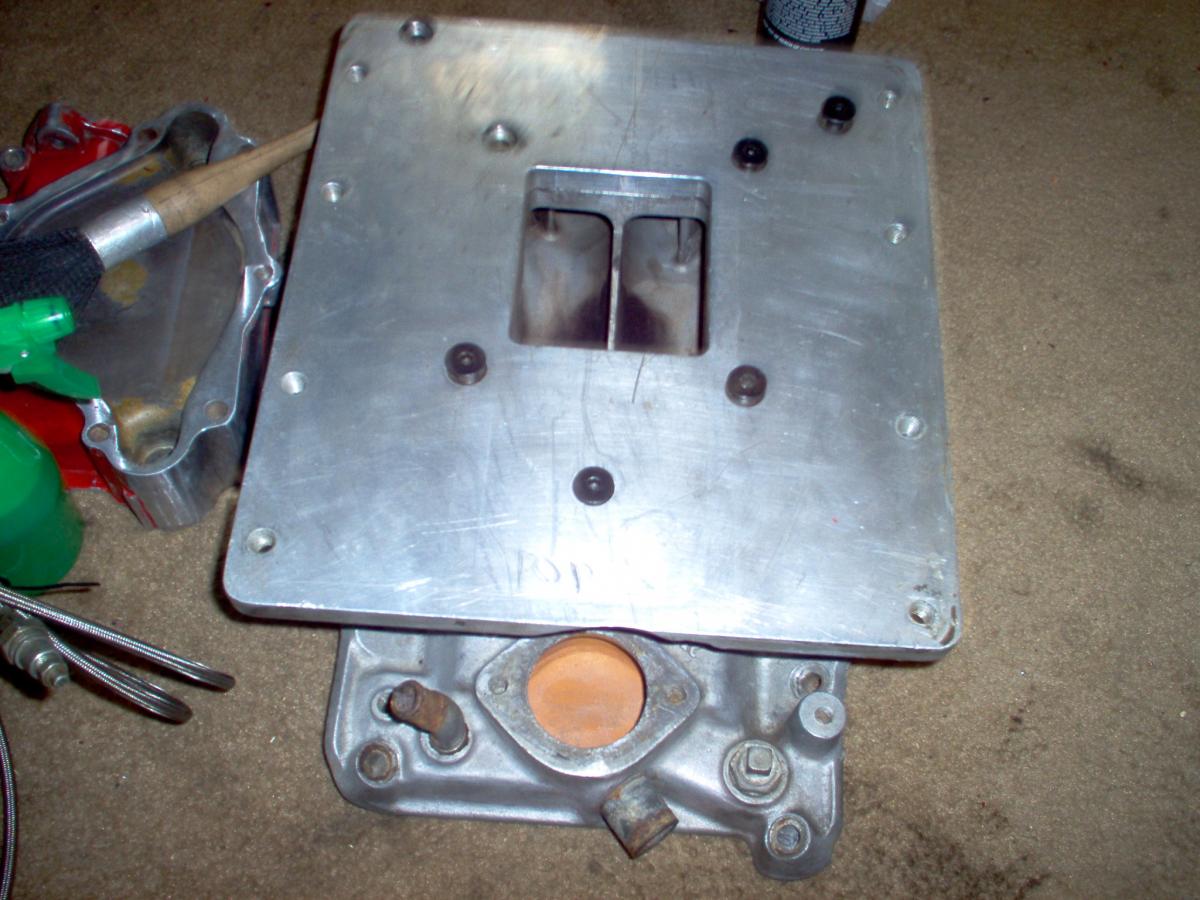

ok heres the deal,, BDS will sell you a kit,the intake manifold is made by hampton, this is the hardest part to get,but available, my intake is a very old style offenhauser converted by dyers blowers,with a pop off valve,,works great ,was on a duster that went 10.65 in the 1/4, but i dont know if dyers is back to making intakes again or not,,google dryers machine shop alsip ill,,

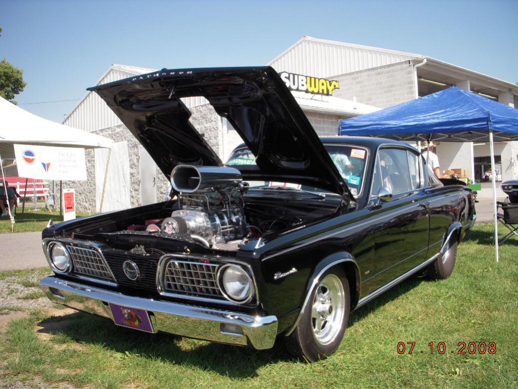

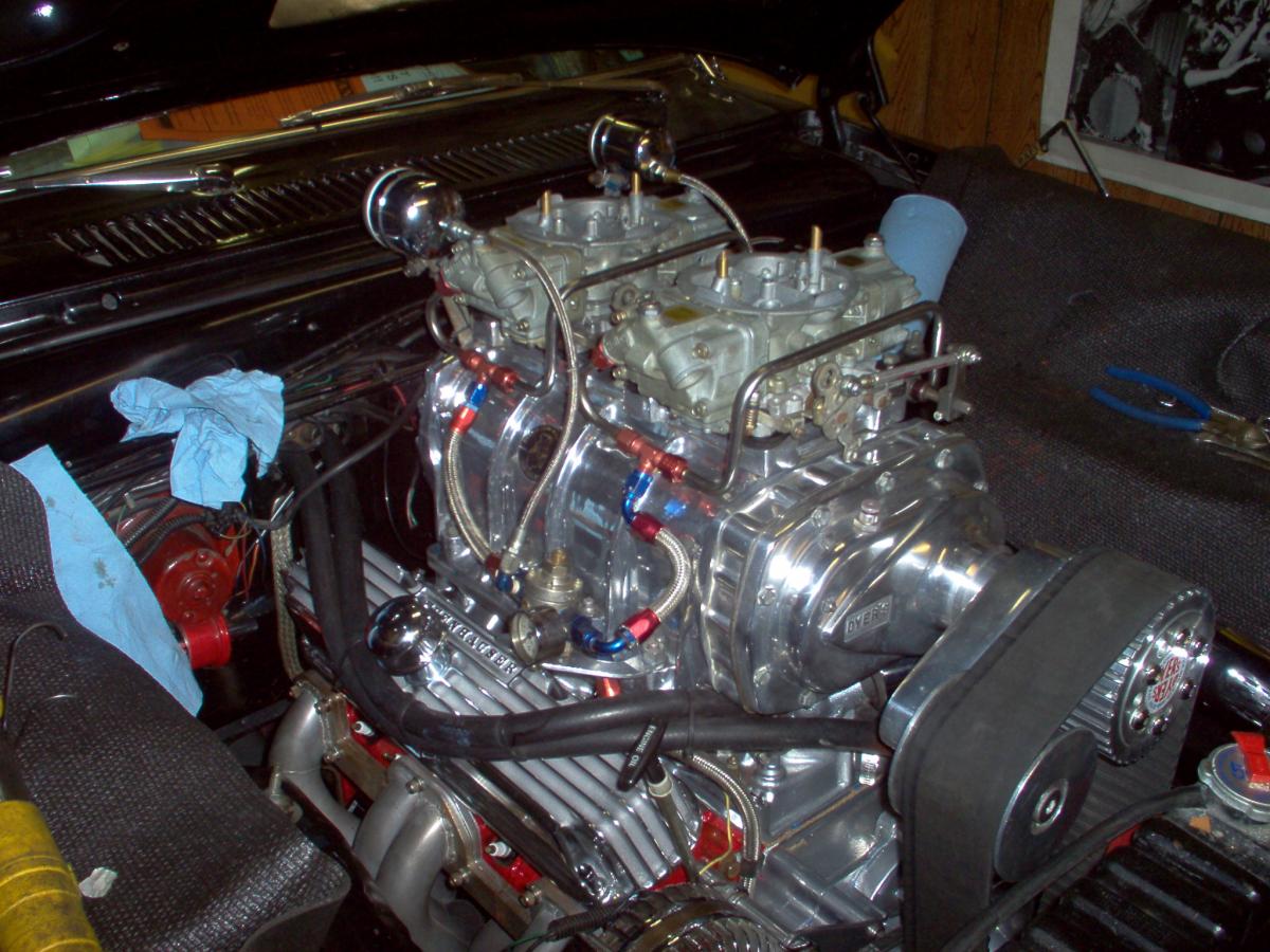

this all sounds like a ton of work but its not really,, just do it right the first tme and figure out how you want to use this car,,,here are a few pics i hope ,,they load,,,,sorry this is an A body car,,,not a B body

hey fast. that is one very nice blown Sb Mopar. love the VC's. Dyers is my favorite air pump store!!
