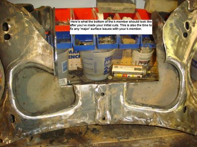

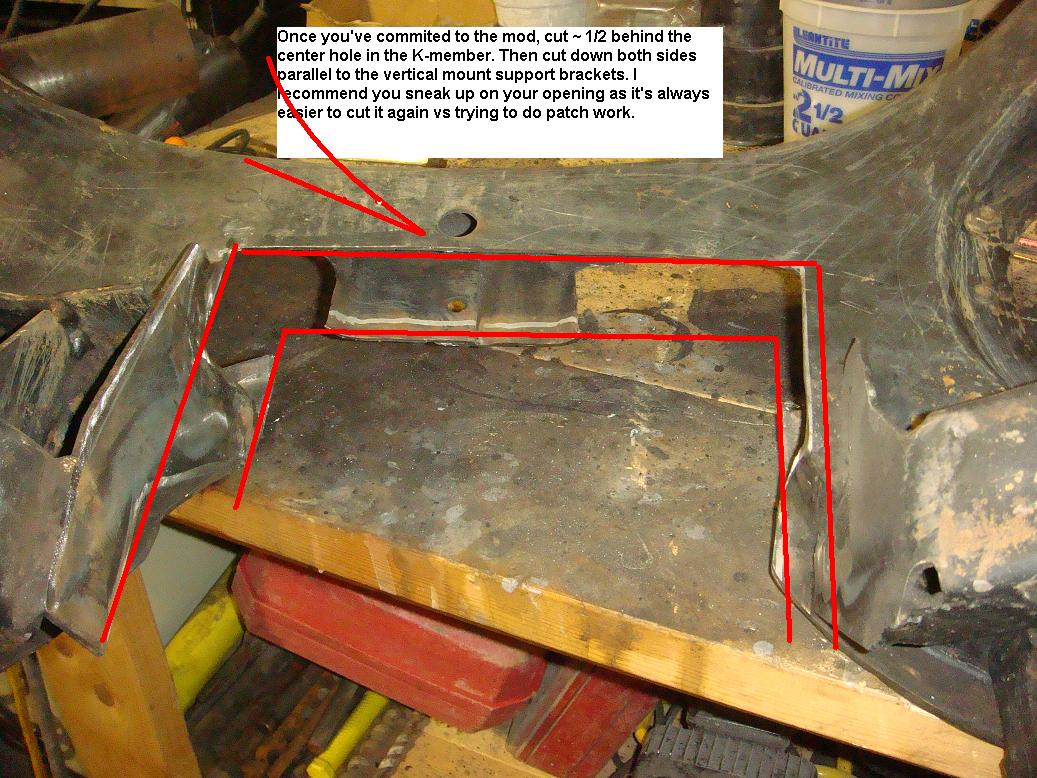

Here's a shot of the mods from the top of the k-member:
A shot from the bottom:

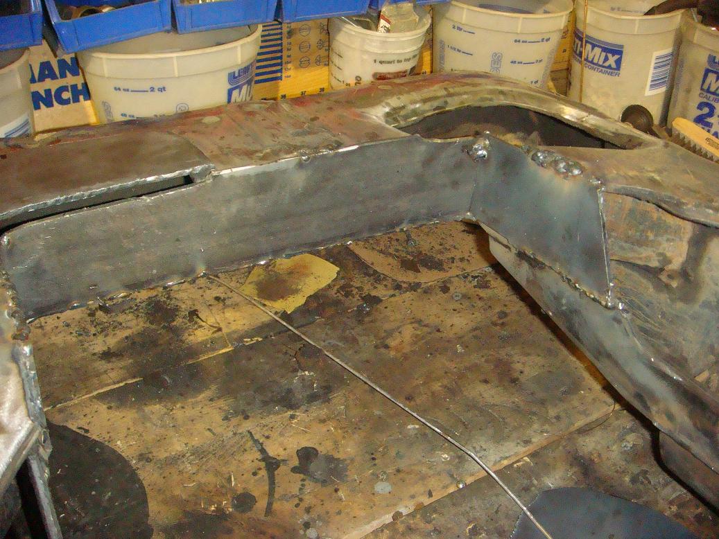

Here I've started boxing the unit in:

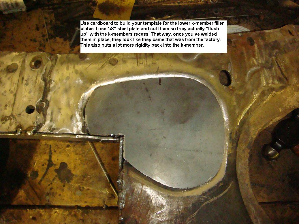

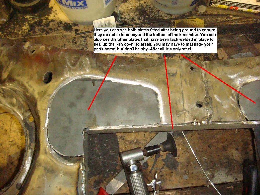

Lower Plate mods
