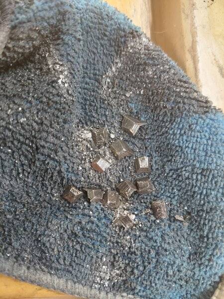

Well I dropped my third member to fix the leak that had just recently started, finished scraping the old gasket and went to clean out the gear oil that didnt drain out of the bottom of the housing and was shocked to find chunks of teeth at the bottom. I have a 489 case 3.55 cone style sure grip that had no noticeable issues. Sure grip worked fine with no whine or weird noises. I have no idea how long they've been like this, but I cant imagine it can be good to go back together like this. I'll attach a picture of how many chips of teeth were in there. Are there replacement gears out there for it or is it toast? If so would it better better to switch to the clutch style sure grip unit?

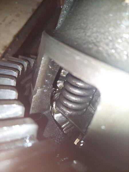

Are you sure those teeth came from your centersection? Have you taken it apart?
You describe no problems with your cone style other than a leak. I wonder if those teeth were from a previous open rear.
Just wondering. If they are from your cone, yep, its time for a new sure grip.
You have the good one and it is worth fixing I managed to find an NOS clutch pack when I did mine. As said above, you should take it apart and see if it has an issue. Tip, use the axles to align the clutches when assembling.

Thats what I was hoping for when I found the chunks but check that out. Luckily I think I found a new 3.91 dana style sure grip third member and will get a new sure grip unit for my 3.55 set eventually.
