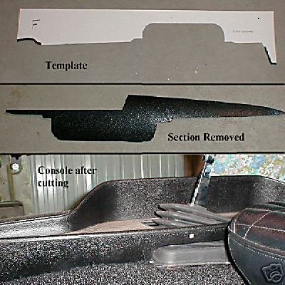

Ma snart..is that a fiberglass tunnel or sheetmetal?

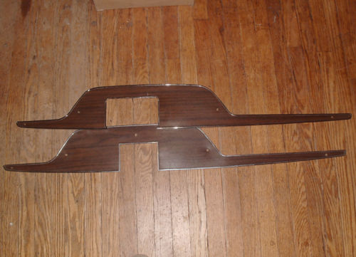

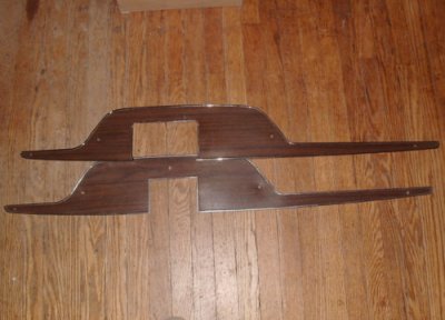

They made 2 different consoles for automatic and manual. They look almost identical. I think you can swap the top plates between the 2 and make modifications to the driver side of your auto console and make it work. I think it would be easier to find a good used manual console and then sell your auto console. Here is a picture showing the difference between the 2, manual on top. And I almost forgot, they mount on the hump differently too.

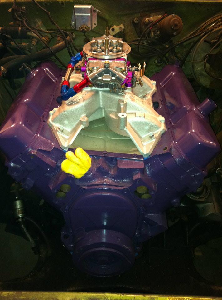

one way is by your harmonic balancer on front of motor .. if its only like 3/4 inch thick its most likely internal balanced and if its a couple inches thick it is external ......also if there were wieghts on the tork converter its a good sighn of external balanced... maybe someone can chime in on this too
being its a 67 motor its mostlikely its a steel crank and internaly balanced

here is a picture of mine ..you can see its about 2 inches or more thick so mine is externaly balanced .with a cast crank...so I had to have a balanced flywheel
