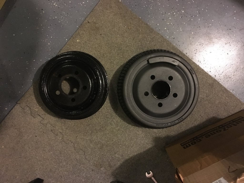

Well I listened to everyone's advice after putting on the 10" backing plates I decided to purchase 11" set up. I originally only saw them on year one or some site like that for a few hundred bucks for the drums. I asked the guy at autozone while I was getting oil and they sold finned 11" drums for around 50 bucks each.
