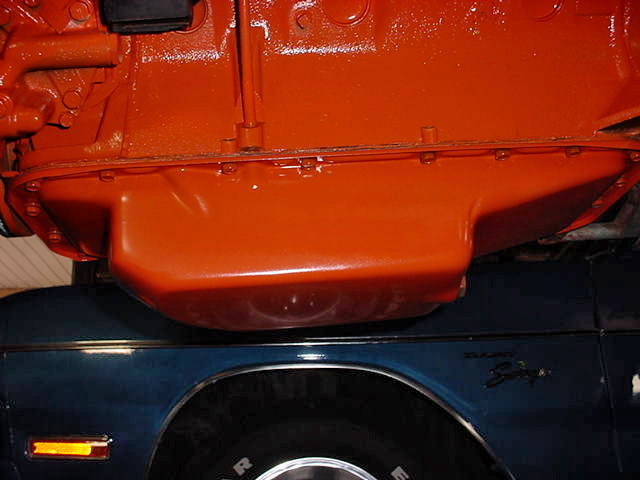

Can you tell me from a pic If I have the correct pan or do you have a pic of the correct one?
Thanks.
This is a Max Wedge pan,the portion that fit's above the K frame is approximatly 5 1/2" long.The standard 62/65 pan is the same length in that area.In 66 they moved the K member back 1 3/4",that is why you can't use a later pan,it will hit the sump.Find a pan with at least 5" in front of the sump and you're in business.I "think" the 72/3 400 pan will also fit but never tried one.
So I'm thinking this pan will work.

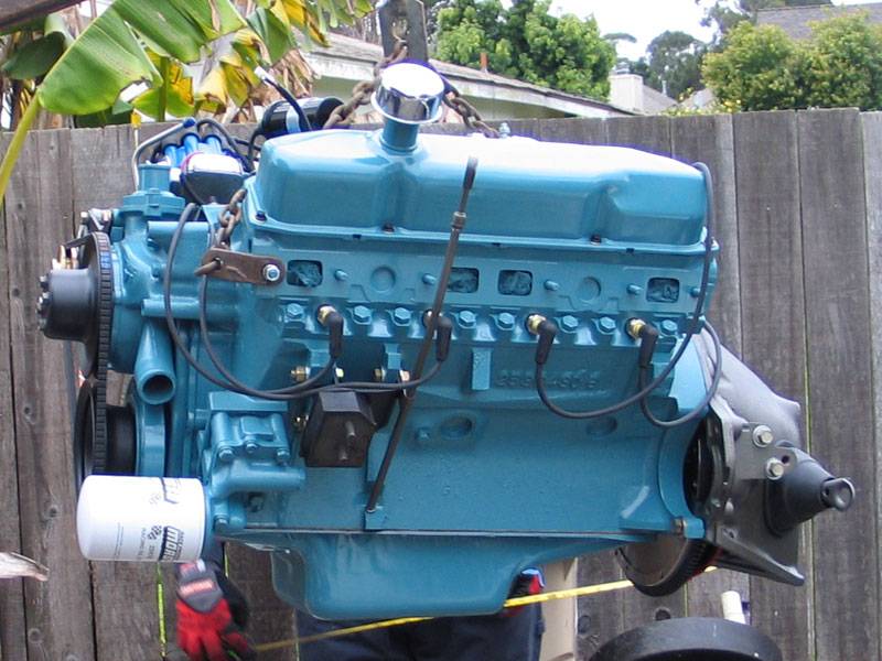

This is my motor

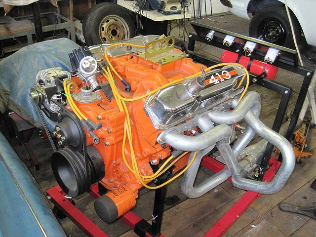

Motor in
Any pictures under the car around the oil pan k frame area? Would like to see how the pan fits in the car.Thank you
Doh, I knew that but I didn't find the 3rd pic. Sorry.
