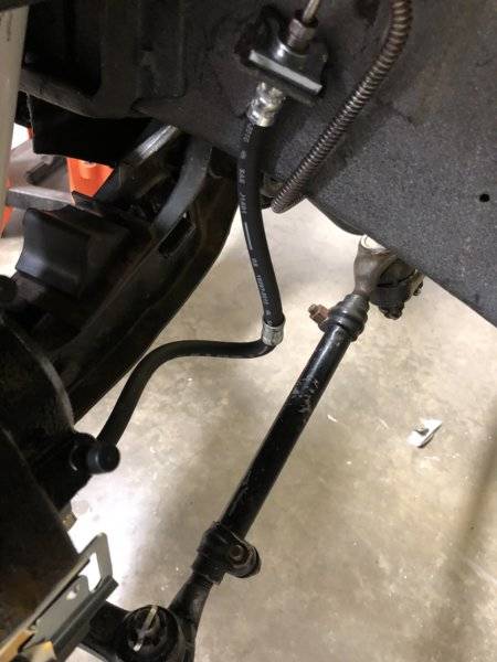

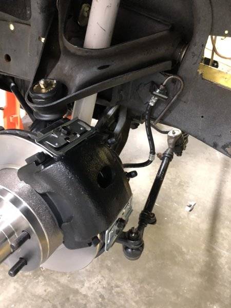

When you swap the knuckle to rear mount on the 69 use a 15” brake hose. Mid 80’s dodge diplomat hoses or 1969 camaro brake hose will both work for this. When you install the hose do so in such a way that it won’t rub the tie rod end adjusting sleeve or the lower control arm. I’ve attached a couple pics.

This bottom pics makes it look close to the control arm, but it’s not, it’s just the angle of the pic. Had my friend run the steering from side to side to ensure no running/kinking/or anything suspect. Keep an eye on the hoses more often than you might normally for wear, cracking etc... they may need replacement sooner than a hose routed the normal way
