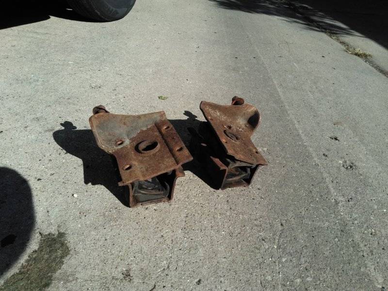

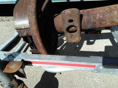

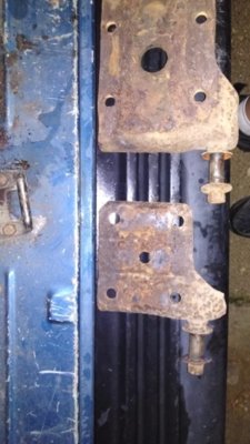

71-72 is different from 73-74. There may be more differences from there, but I'm not sure. They changed a few things suspension-wise like halfway through 73, but I don't believe it affected the rear end itself, just the leaf springs as far as the back goes. At the very least, the perches are different from the 71-72 to the 73-74, though. 73-74 added rubber isolaters that changed the perch dimensions, I believe. You can get past this, but I'm not sure how much work it takes. People have done it before.
The difference in 71-2 and 73-4 (see pics). The larger shock plate and pic #4 are used on 73-4,pic # 2 is a 73-4 spring perch
