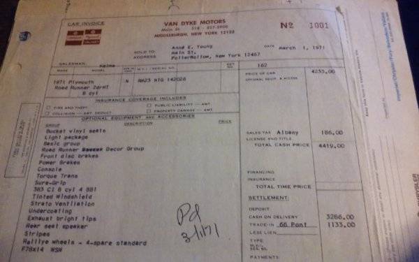

I have a 71 road runner and I'm always ask why no ralley dash? I have no idea why? My car has lived next door to me since inception...I know nothing was changed...any ideas? Thank you....
Also has silver on the lower part of the grill which I thought was Satellite, you sure it wasn't born a Satellite and changed into a road runner at some point?
I have the original bill of sale for my car. I have no idea why sweeper dash...lol
Has A/C vents in dash but no A/C, just the stratovent, strange. Maybe your car was mistakenly started to be built as a Satellite or just built on a Monday with a number of errors?
I can't read that build sheet.
VIN starts with RM, and matches rad support and cowl?
Well the build sheet does say RM23, 71 road runner , 383 4bbl, rally wheels.. so it does seem odd no rally dash but then again, we know how they liked to spend their lunch hour on the assembly lines back then...

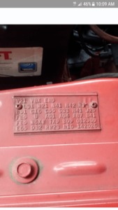

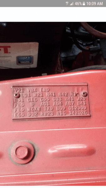

I posted the vin plate and fender tag
That dealer invoice looks a little suspicious to me, the details of the standard equipment and options are not specified as to what is included in base price and what is an individual option and its price. I have a bad feelings about this vehicle.
I haven't seen them. I did look at your photo garage and saw the door sticker but that doesnt help much either. Beautiful car either way!!

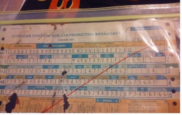

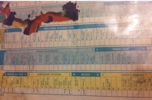

If you can repost the VIN plate and fender tag. Also pull up the back seat base and see if the actual build sheet is there. The build sheet should have the definitive answer to the sweep dash question.
Does it have a front stabilizer bar, the correct diameter torsion bars, heavy duty leaf springs, and 8 3/4 differential?
The vin, fender tag and build sheet are shown in his garage pics. Body numbers should be on the cowl above the wiper motor area and on the radiator support, either on the top or back edge.
Is there a pic with lines 6-8? Copied these pics over from his garage. Finally found them...
Screenshot_20171011-100833.jpg Screenshot_20171011-100911.jpg Screenshot_20171011-100951.png
Definitive test will be body stamps.
Fender tag and dash are bolt-ons.
