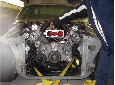

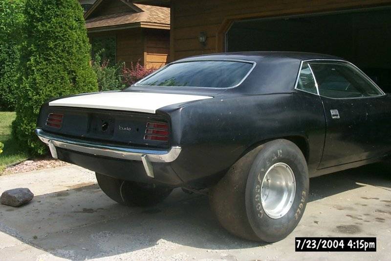

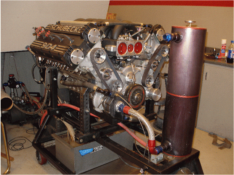

I have some good reviews. And happy owners. (Once they actually received.) I'm more curious on how much would one actually put to the A855? With today's multi disc clutch options? A 1000 horse might be doable? The reason I ask is because of an E-body 904 CI DOHC monster build I'm playing with. Easily 1100 horse NA on pump gas. The build is targeting what our track's 3 race circuit calls "King Street." So yes, it has to have some road capabilities. I have JW glide for it. With a GV OD unit that can easily handle the power. But that thing will heat up like Hell at high noon in street duty. The car was a modified stock Hemi in its hey day with a A833. So all would line up. But just fear would come apart once a 1000+ ft/lbs of torque hits it. And that's at 2500 RPM.
And yes, I understand the "That's just stupid for a V-Code 70 Cuda." But car is heavily modified. And motor/trans long gone. I bought as rolling body 15 years ago. It has not moved under its own power since 83. So what is a dumbass like me supposed to do?
