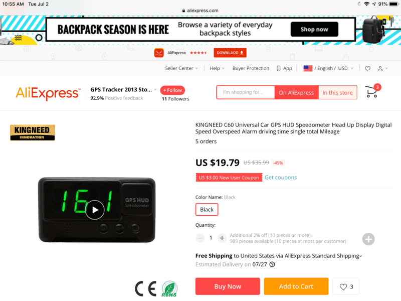

I did it and other than reading the wrong speed, it operates. BTW, it was reading the wrong speed before the change too (different gears in the rear). I bought the more correct speedo gear but I haven’t installed it (for 15 years now). GPS speedos are very accurate and if you want accuracy, buy a cheap Chinese heads-up-display unit that sits on your dashboard and reflects on your windshield. You can put it in your glove box during car shows. Buy it here: https://www.aliexpress.com/item/330...chweb0_0,searchweb201602_1,searchweb201603_53
