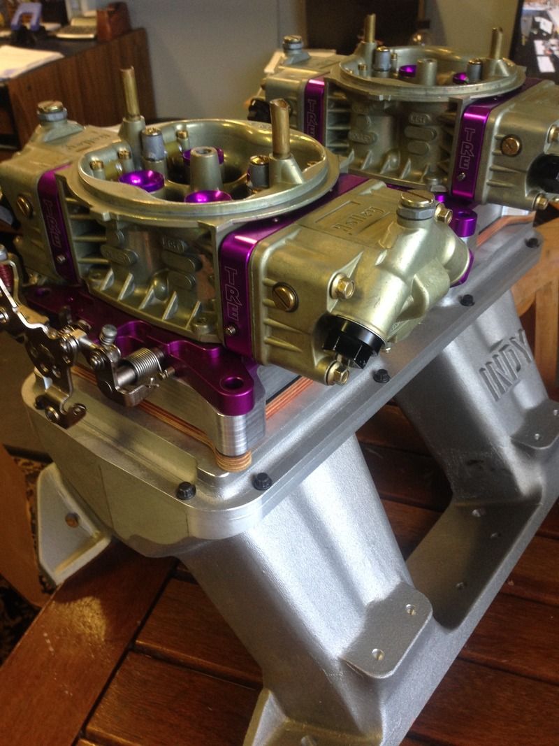

Well these carbs came up cheap and I could not pass on them, 950 TRE's, got them for US$1000 for the pair and the tunnel ram showed up, should do the job.

try looking at a first gen camaro pedal and rod linkage to use

The reason for the harsh pedal is not the linkage or side mount vs inline. Its the carb. 4500s have stiff springs on the primaries and seconderies. And 3 linkage setups internally. Staged,progressive and 1-1. So when you get to the secondaries on 2 dominators with staged linkage(most common) things start bending. The first year of pro stock racers were fighting this. Thats when holley came out with the progressive or soft linkage carbs.
Have not been far because Im waiting on air filters but Jeeeesus it seems to have picked up a bit of mumbo, at around 40mph I opened the primary's only (about half peddle) and it wheel spins. Sitting in park, give it a quick stab and it brings the 6200 shift light on. Are these tunnel set ups renowned for making an engine rev quicker or more freely ?
