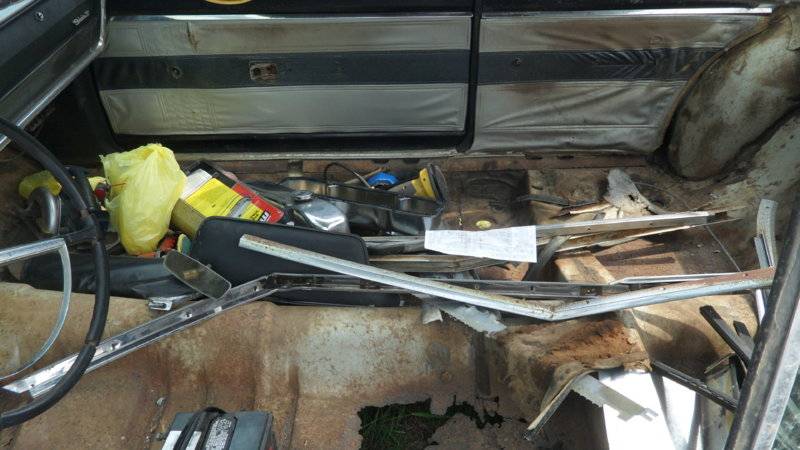

Getting close on finishing installing $7,000 of sheetmetal on my 68 superbee. Getting to the final pieces and wouldnt you know it, i didnt take pictures or save the floor pan pieces to figure where the new ones go. These are the wire tracks that are welded to the pan on top of the rockers. Anyone have a pic of theirs? Plus both the pass and drivers side had them?

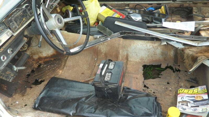

This is my old 67 But the wire covers should be the same. Look at the top left of the picture. They are just under the door on top of the flat area where you spot welded your pans in down the outer sides.
there on both sides they help contour your carpet into your sill plates that screw to your rockers, AMD sells them I think.
Great feedback, great photos and appreciate the help
Possible for a closer pic for front to back positioning and alignment.
