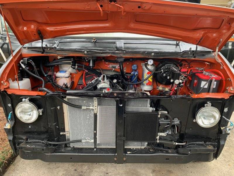

The 318 I rebuilt for my ‘79 B100 project will not start. I’ll list specs, then diagnostics I’ve done.
I'm going to err on the side of too much info. Any thoughts are appreciated. Thanks.

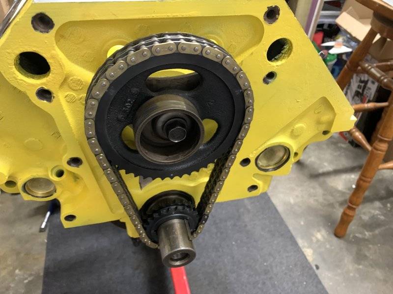

Progear Timing Chain and Gear Set

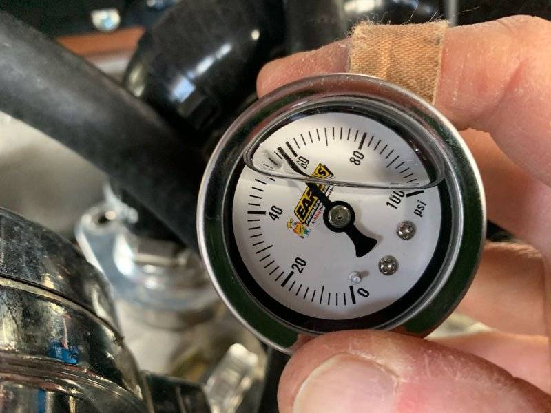

The sump is delivering fuel to the throttle body at an ideal 58 psi, per the inline mechanical gauge.

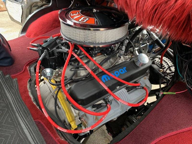

The ignition coil in the distributor cap is receiving that voltage (confirmed with multimeter).
The ignition coil is providing spark (confirmed with spark light tester).

I have adjusted timing from scratch multiple times.
Engine is at TDC on the compression stroke.

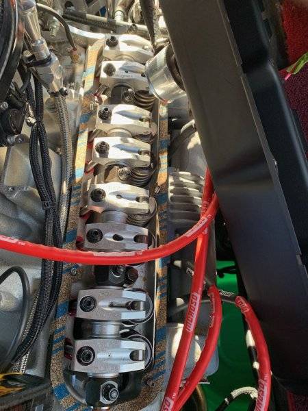

Top end oil delivery to the valve train is sluggish.
Oil is oozing from some rockers; others are dry.
I think the oil delivery holes may have been plugged with assembly lube during prime.

Other than the sluggish oil delivery, the valve train appears to be working well. It taps away during crank.
The valve train makes no weird noises. I installed everything to spec.
The pushrods appear to be the proper length. I see no strange seatings or abnormal forward-backward movements.
The valve springs are being compressed and released.
I am paranoid that the valves are somehow not being opened and closed properly, but don't know why this would be.

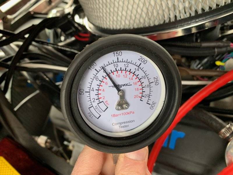

I've tested each cylinder by threading in a compression meter (obviously, when the engine is off and cold).
The even cylinders all register 110 psi.
The odd cylinders all register 100 psi.
These numbers are low, but shouldn't they increase at throttle?
I have read different opinions of 318 cylinder compression, recommending stock levels from 100 psi to 135 psi.
Even at 100 psi, it seems like the engine should start.

I got so aggravated, I bought a TDC indicator and used that to confirm my position. I’ve been using the finger method to make sure it’s compression, not exhaust. But, just for the hell of it, I rotated the distributor rotor 180 to see what would happen. Still no start.
I have not tested my plug wires. I know the coil is sending spark, but have assumed the wires are delivering it. Why would the wires be bad? I’m planning to cut my own after I finalize timing, but have just assumed the Morosos are working. I will make sure tomorrow, when it stops storming outside.

I may remove the rocker arms and thread a wire down thru the cam holes and reprime to ensure top end oil delivery.

Compression is, enough , given it's never fired and new.
There was no mention of rocker adjustment. And how that was performed. But again, compression is fair
