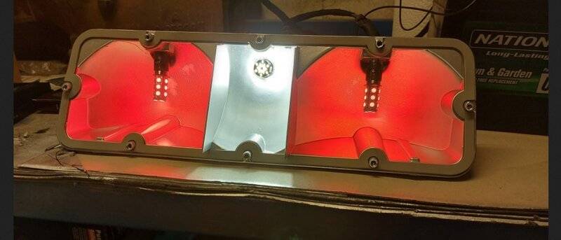

Here are the bulbs powered up.

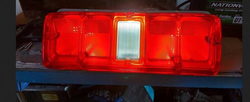

Here's what it looks like with the lens on.
