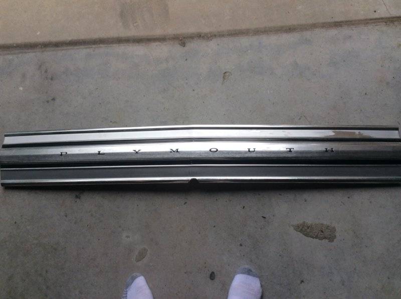

Someone gave me a nearly flawless tail panel and i’m tempted to put it on my 68 RR
It has a few scratches and maybe a few very small dings that can be filed or sanded out
My question is how do I get that original brush aluminum look in the center section where the Plymouth word is 0A8AA2B9-65F4-4F35-9911-2C4C2C285BC7.jpeg

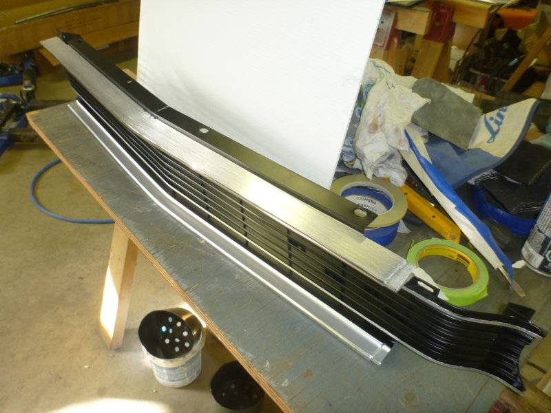

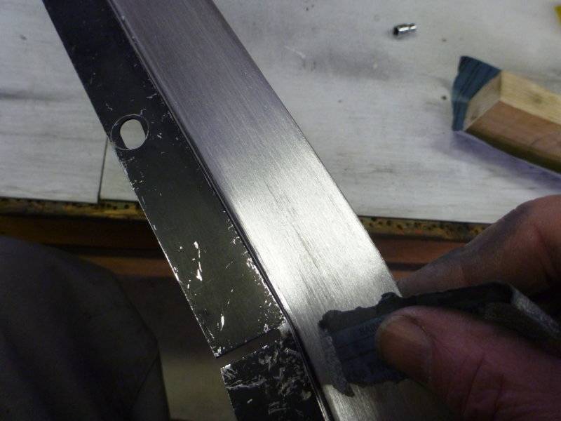

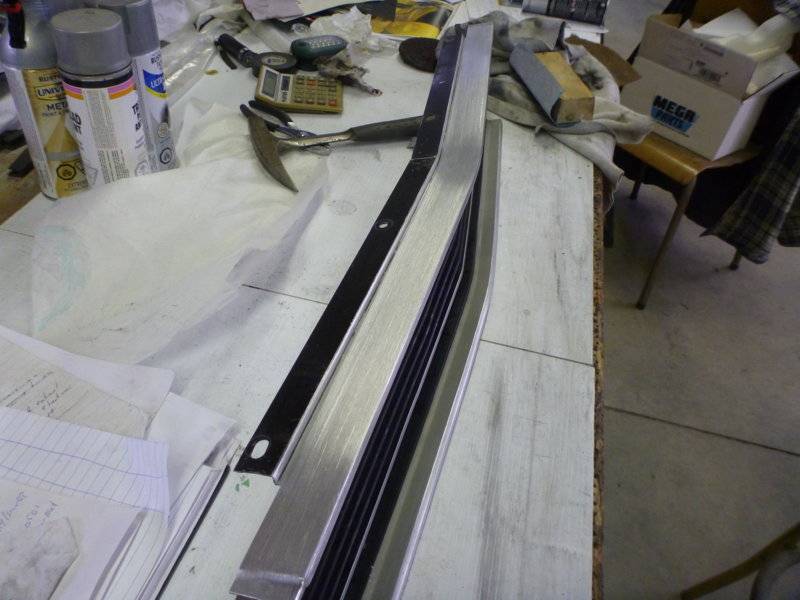

Sand paper being VERY careful to stroke straight! What I did on my Bee grill for the top surface to return it to "as made".
