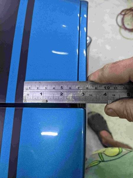

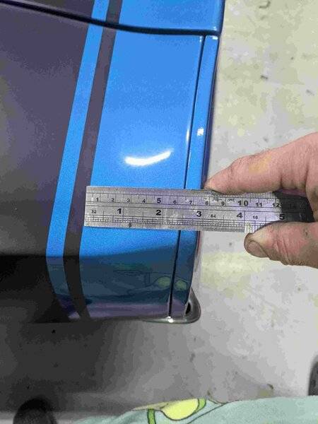

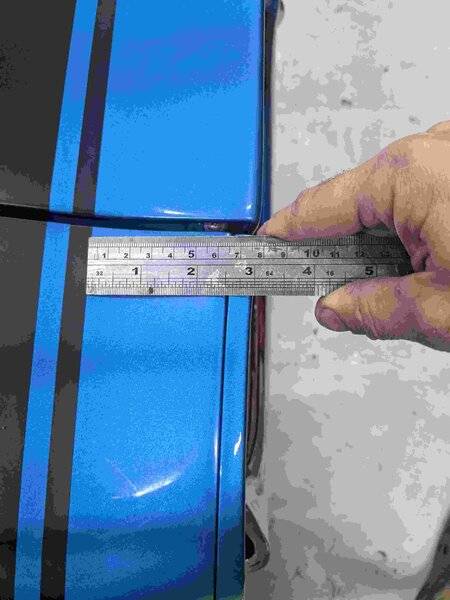

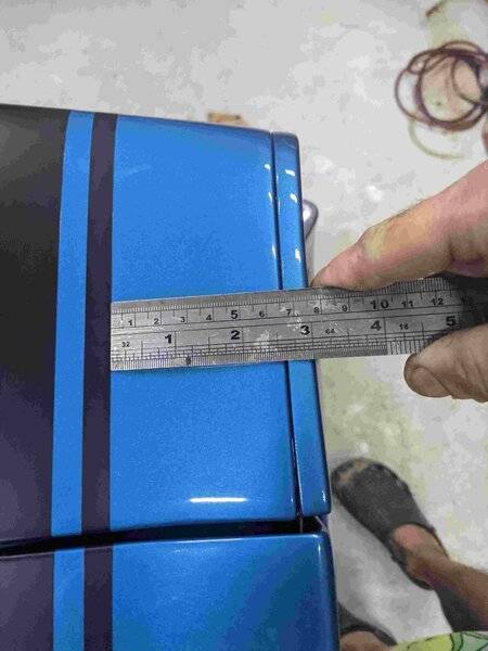

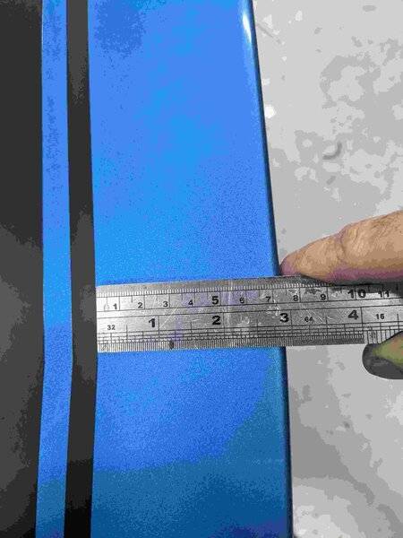

I laid the 3 pieces out and centered over the side marker. As it rounds over the quarter has me on edge. The most likely will lay better once the backing is off and they are sticking down. Reference measurements at the top of the quarter and a couple along the trunk would help me feel more confidant.
Hope this helps, starting from right to left
