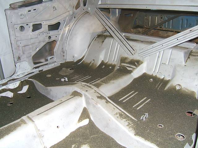

i just media blasted most of the 71 and
i'm welding in the rad support/ inner fenders right now.
then i will attack the rear.
