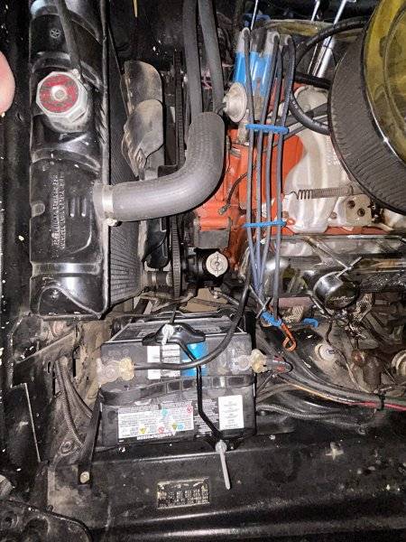

I was changing the oil in my charger yesterday and got thinking, if there was a fan shroud in here I might not be able to get the filtre out without taking something apart.
It’s already tricky enough to get a filtre full of oil in and out and install horizontally. In fact, before I bought the repro battery tray, there was some other kind of tray in there and I had to put the filtre between fan blades and rotate the fan as I pulled the filtre out.
Anybody versed in this? I’m close to pulling the trigger on a repro fan shroud but before spending $600 I’d like to know if this will be an issue.
By the way, this is a 69 charger with 440 and 22” rad.

My sway bar and trans cooler lines are blocking the path. The only way in or out that I’ve found is between the rad, power steering pump and battery

Same situation for me and it stopped me from putting a shroud on. My cooling is good anyway. I've got the bigger 26" or whatever AC radiator. No chance I could get the filter out without dropping the bar or taking the shroud off.

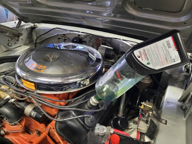

Why put oil in the new filter?
Some say fill it, some say don’t worry about it. I put about a half quart in. It doesn’t really spill out when installing but that’s not my main concern. There’s oil everywhere in my engine bay and garage floor haha!

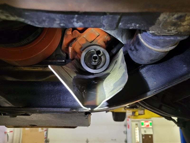

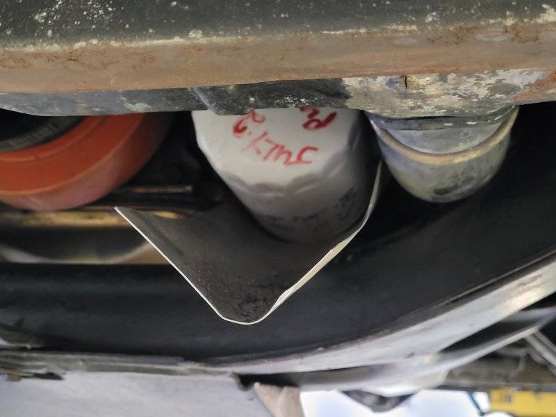

I cut up a windshield washer bottle and make a low profile drain trough. I have power steering, transmission cooler lines, sway bar, and a shroud and the filter comes out without removing anything.
Now, the new oil filter gets primed by filling it about half way and letting it sit for awhile. I'll grease zerks, lube hinges, wipe off the underside, etc while the oil filter is soaking up the prime.
Then quickly invert it around and put it on. Never spilled a drop.
