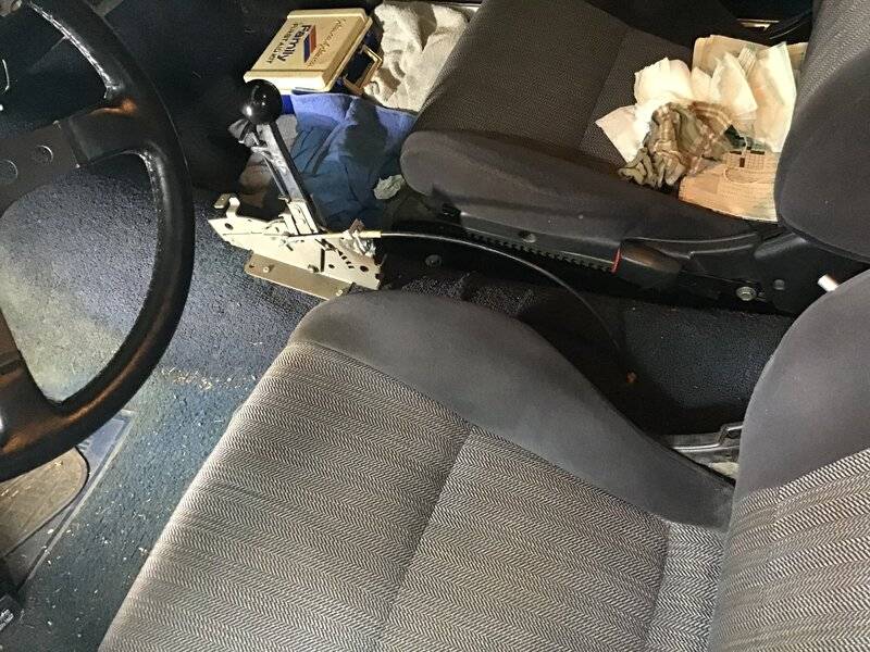

Yeah that is why I finally tossed the cable in the trash and built a solid rod shifter.

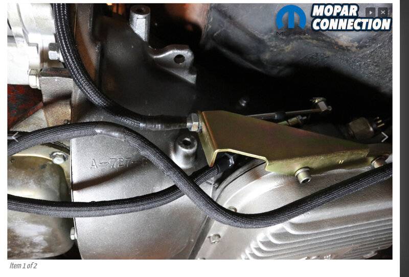

Mopar Connection did an article with a TCI shifter install and noticed in the picture how the cable did a sharp bend up before the bracket. Is there that much flex in the cable without binding?

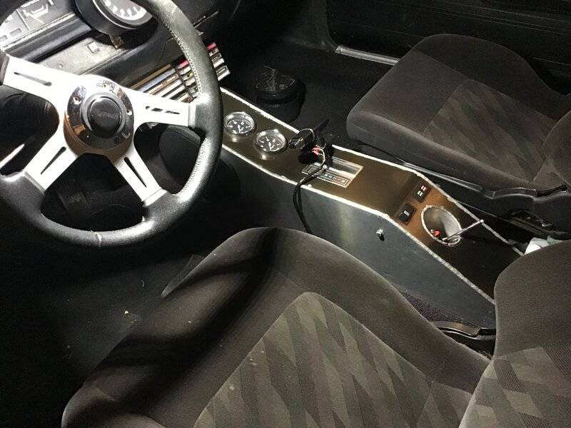

I couldn’t possibly see cables going forward into the starter, headers and kick down cable. I did some welding and made mine rear entry. Of course you need to reverse the tranny mounting too. The exposed cable is in my kind of rat rod Dart, the other is my RR that I built a console for to hide the cable.
