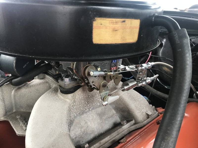

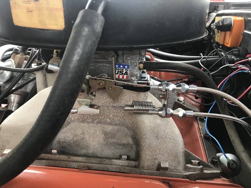

Here they are all setup on the 440.
0A31236B-B744-49DF-BA0C-16BAF0C98C02.jpeg 1B9324E9-F4C9-4EE6-859E-2A19C0C33226.jpeg
From looking at your picture, it seems like you may need the Holley throttle adapter for Chrysler. The longer lever should make the throttle cable easier to pull. I am not at all familiar with the aftermarket cable operated kickdowns. The Bouchillon seems to be favored over the Lokar, from what I've heard. I've put manual valve bodies in all my transmissions. I don't miss automatic function one bit. https://www.holley.com/products/fuel_systems/carburetor_components/brackets_and_linkage/parts/20-7
