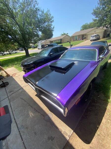

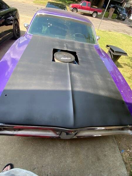

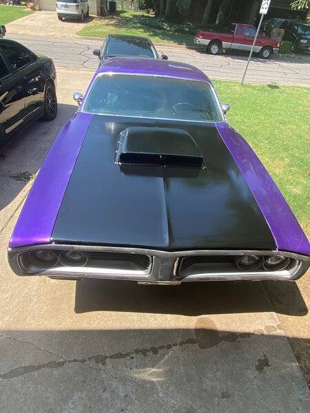

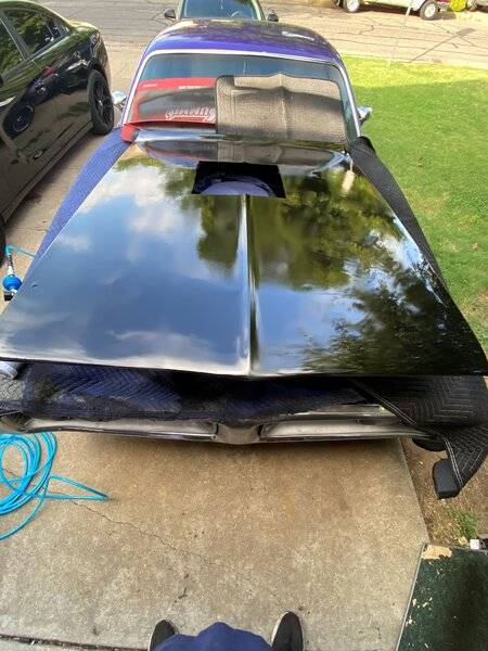

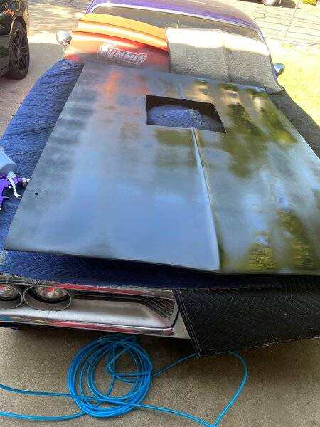

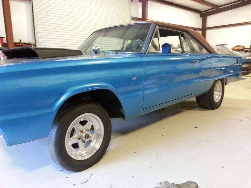

i had to go at this 3 times before i finally got it where i wanted it.. its by no means perfect, but i can say i did it.. next i have to paint my front and rear valances since they still have yet to be painted

Congrats, looks good!
I'm one of those that wants to do as much as I possibly can, good, bad, I still take pride in saying that I did it myself.
I hope you do too!

yes sir.. other than the purple paint i have done all else.. interior, engine, rear end, Headliner(put in from a wheel chair).. i also go the honor of my car being on the cover and in the next issue(sept/oct) of Chrysler Power Magazine..

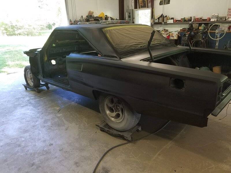

Looks good. Black is terrible prep. I also learned single stage as well. this was my 3rd paint job and feel comfortable doing it. I've now invested in a pop up tent and good equipment. I've got friends & family asking me to spray their cars and a few motorcycle tanks / fenders. A little extra cash in the pocket for another skill i guess.

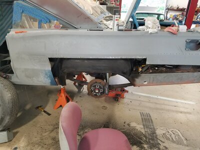

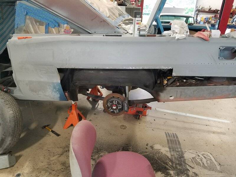

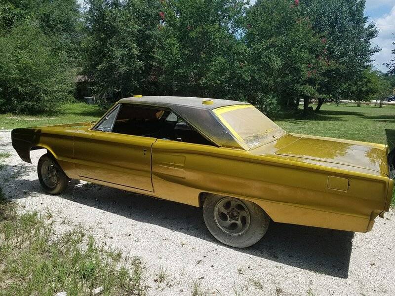

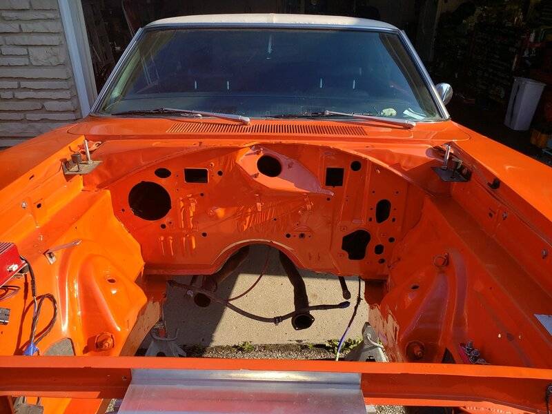

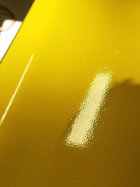

Mine went from this to gold, a lot of patching panels and body work. The sealer and paint were pretty easy to apply and came out very well for a 1st timer.
I screwed up, I had a refrigerant drier but did not wait and tie it in the the system, and sprayed my clear with just a desiccant on the gun. I didn't drain the compressor prior too and ended up with a little fish eye.
Luckily I was able to cut and buff most of it out. Again I'm pretty happy with it.
