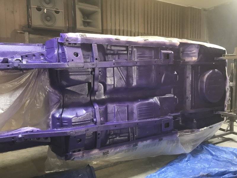

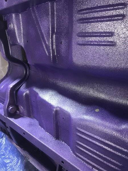

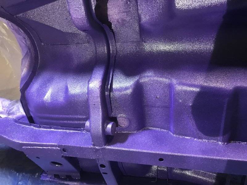

I like bedliner for the underside. Not on every project , but I used tintable raptor from upol. Did it on the rotisserie and it was nice. Wanted a little added protection underneath. As far as rockers, I would go with chip guard though.
I like bedliner for the underside. Not on every project , but I used tintable raptor from upol. Did it on the rotisserie and it was nice. Wanted a little added protection underneath. As far as rockers, I would go with chip guard though. View attachment 1892481View attachment 1892482View attachment 1892483
