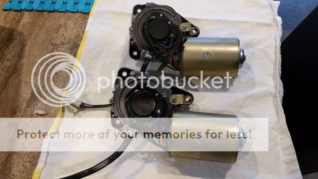

1 - 1969 b body, 3 -speed wiper motor - what color is the barrel on the motor. Appears to be some kind of copper zinc?

Not positive on the color, but if it is a "copper-zinc" color it was probably coated with a zinc chromate coating (very toxic & no longer used). You can probably mimic it with anodizing (really close) or get in the ballpark with some custom-matched spray paint.
For the lights coming on..... I'd look for a wire crossed/shorted somewhere. I can't remember exactly how the 3-speed wiper motor works, but it has one wire for each speed coming through the bulkhead disconnect (top plug if I recall correctly) so there's several wires that could get crossed/melted into another wire. Does ANY speed turn the interior lights on?

Beekeeper has a good thread on this with duplicating the color with paint. My guess would be yellow zinc or cadmium.
I did mine in yellow zinc and they turned out perfect.
I agree they do look good. Does the barrel come off by taking out the large screw in the middle?
