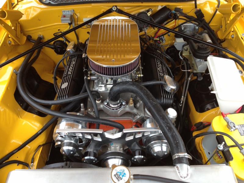

You said ANY stroker, so here is my 440ci small block build.......
440ci R3 Siamese race small block 11.1 compression (pump gas)
4.185 bore 4" stroke
Eagle 4340 steel crank
Eagle 6.123 H-beam rods
Diamond pistons
Indy 360-1 fully CNC'd W2 aluminum heads with 2.10 x 1.65 valves
K-Motion roller valve springs
Titanium retainers
T&D 1.5 roller rockers
Comp solid roller cam & lifters .276/.284 - .658/.661
Indy ModMan intake port matched with dual 750 Eddies
MSD Pro-Billet dizzy
660hp @ 7000rpm
575tq @ 5100rpm (At the crank)

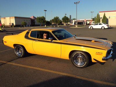

All tucked into my 1974 Roadrunner
1 7/8" TTI ceramic coated headers
3" TTI ceramic coated X-Pipe exhaust
Flowmater Super 10 series mufflers
TKO 600 trans
McLeod twin disc clutch
Dana 60 w/4.10 and Eaton Tru-Trac LSD
Wilwood 4 wheel discs
