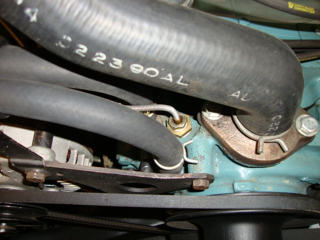

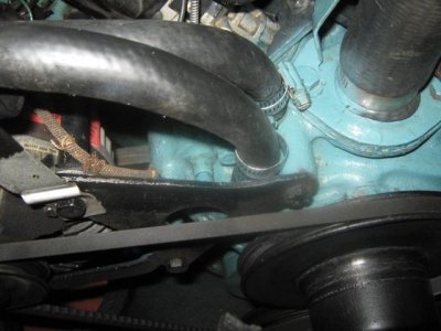

There is a brass adapter that will go into the waterpump that goes from small to large allowing the large temp line to go into the w/p.

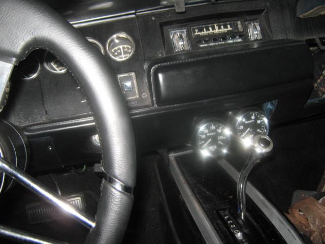

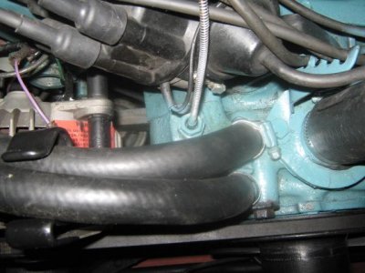

decided to give up the fight and remove the heater hoses....I blocked off one and used the other port for the temp gauge. That allen plug was not coming out...period! I've had everything off the front of the car three times already (grill repair..new radiator...paint) didnt want to do it again.....anyway the car runs all day at 180 degrees...even when it was 100 out.....Thanks for the help....

where else could the sending unit go? the side of the block is too short.....
The electrical one and mechanical one almost read the same ......im guessing Im ok there.....
your placement is fine,just watch you dont have that mechanical leed rub a hole in your distributor vac advance.i had a rubber hose rub through an ac metal line because of vibration.i normally run that leed under the dist housing(below the cap)
