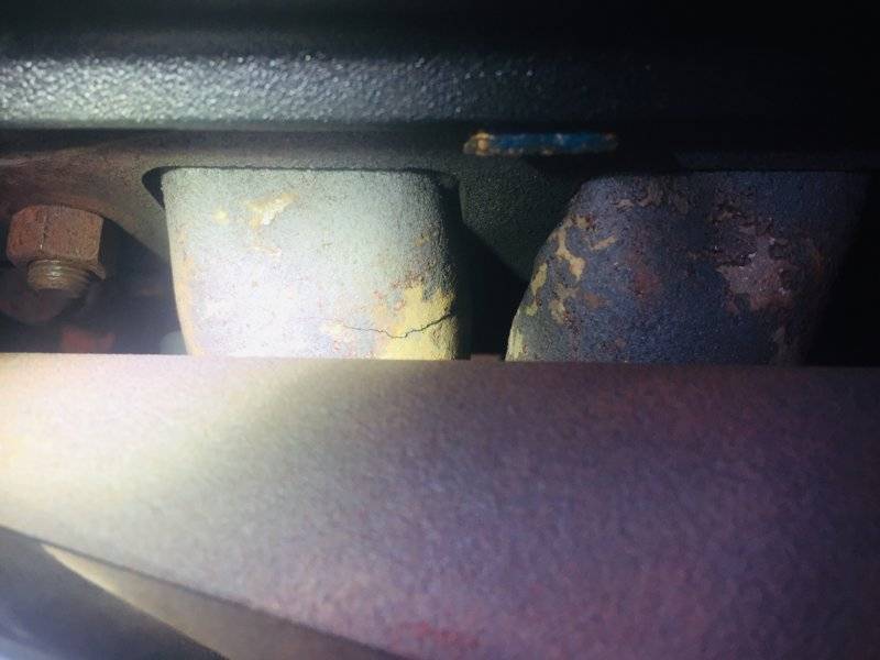

Found myself a nice crack.....
In the header tube of cylinder #3 that is.
What could be done as a temporary fix to prevent it from breaking/leaking without removing so i could still drive it this summer.

As a temporary fix (and I do mean temporary) Clean the area and ruff it up with coarse sand paper then put a coating of JB Weld if you have such a thing in your area. As Frank says above if the metal is thick enough tig weld it. drill a small hole at each end of the crack to keep the crack from running before welding it up.

Unless you fix this properly, the crack will only spread until a hole develops. I tried to jerry rig it and it didnt work.
The proper fix would be to drill a small hole at either end of the crack and weld from end to end.
That would involve removal of header.
Replacing the headers with a quality set is what I would do because more cracks will probably develop.
If you do remove it to weld, bolting it to a spare head to keep it in shape might be a good idea. If you have a spare head, that is.

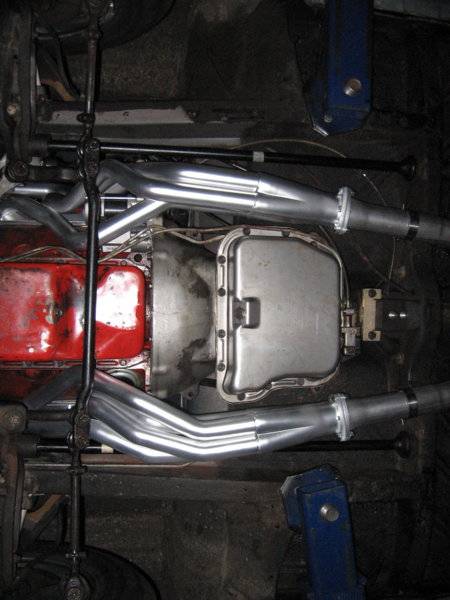

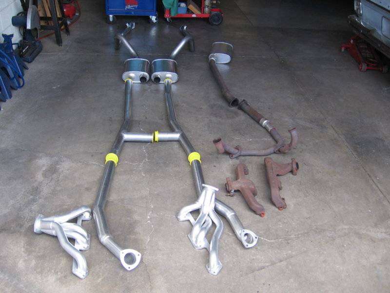

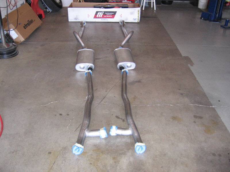

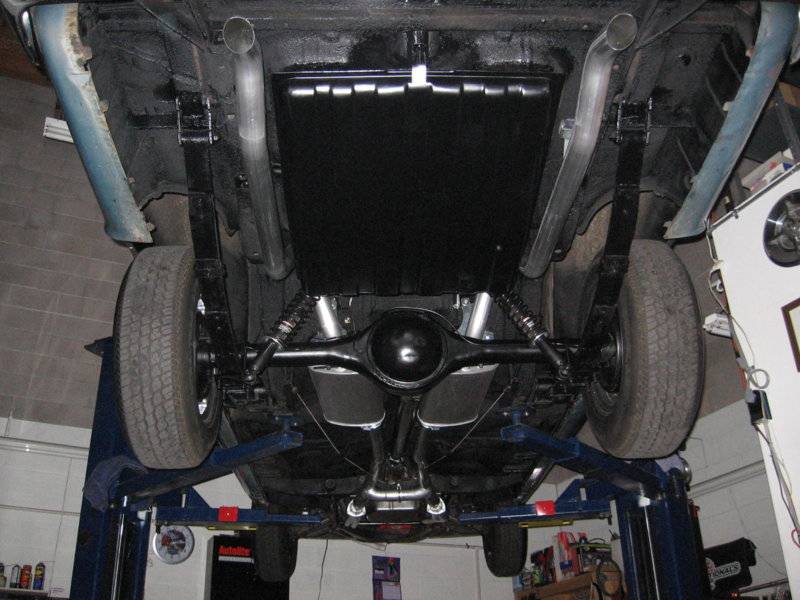

No the ceramic coating would/should last many years.Just some FYI, These are photos of the TTI complete header/exhaust kits. Now these are from a A body small block and are TTI's shorty headers.I did a complete install over on A Bodies only under the "How To Articles" if you wanted to check it out. Also are photos from a 64 Belvedere Poly 318 install.
I have been installing the TTI's for better than 20 years. They sell some good products.

The problem that I've found trying to weld exhaust manifolds, header pipes, wood stoves, is that the molecular composition has been compromised with all of the extreme heat and heat cycles. In other words all of the carbon has been cooked out of the steel. Touch it with a welding electrode and "poof"! you end up with a big hole. About the only way around this is to braze it with a torch and use a much lower heat. Tig it on a low setting with brass might work but I've never tried brass with a tig.
The bandaid and a clamp might be a better idea with the headed still bolted up.

I had a look but will not reach it with TIG, i can get it close but can't see what i am doing.
And indeed, then burning a hole in it will be even worse..

Pfff, i tried all ways but i cannot even get a hose clamp around the damn tube.
Just because it starts like a square, and goes straight to a 90deg bend.
I can see now the crack has gone around already for maybe 70% of the circumference, just holding on the last bit...
I don't want it to blow off and torch my engine compartment with all hazardous consequences so guess i'll have to get some new stuff and just bite the bullet.
