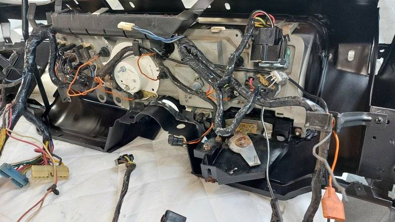

Guys, is there any way to safely test the dash cluster when its still on the bench?
I just installed my wiring harness for my 1971 Runner.
I'd like to test the different circuits before the whole thing goes back into the car?
I switched over to LED's for the dash lights - I'd like to test them to see how they light up the dash.
Sure, supply 12 volts to the black wire terminal of the ammeter or the corresponding alternator out circuit in the bulkhead connector (black 12ga wire at cavity 18). This will fire up unswitched circuits. Will need to jump the ignition switch Molex pins to fire up the key-switched circuits, red to black for accessory and red to blue for ignition 1. Don't forget to ground the frame and the main harness ground ring terminal.

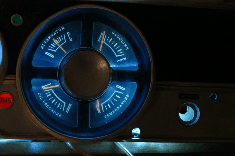

I have a box of old wall wart transformers, I dug around and found one that put out 12VDC and wired the end with alligator clips. It works great when testing dashboards. It's handy to find continuity problems and make sure all the LED lights are phased correctly before it's all back in the car. This was my friend's Barracuda dash that I was working on.
