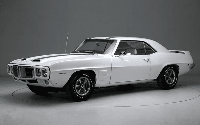

The 69 Z28 is a sharp car, but I'd rather have a 69 Trans Am.
