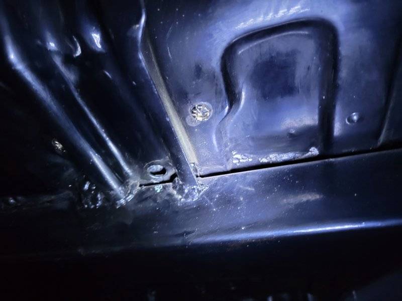

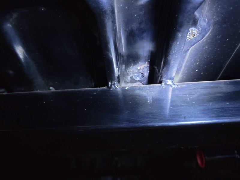

Hello, does anyone happen to know the placement of front bucket seats for a 1969 Plymouth Roadrunner? I have new floorpans and am uncertain where the holes for the seats are supposed to be drilled. Thanks!
No dimples where the holes are to be? Plus, you will need doublers on the inside tracks, as there is no cross member there.
I think that the 2 out side holes may be the same as the bench seat. AMD for the doubler? You will also need the plastic biscuit spacers. My seats are out of my '69 Road Runner, I can pull the carpet up and take a picture if there are no dimples. Here are 2 pictures from below, these 2 cross members should have the outside holes. Then set your tracks for the inside location.
Since you replaced the floor, the hole locations “could” be off 1/2” or so. I suggest you keep that in mind before you start drilling
