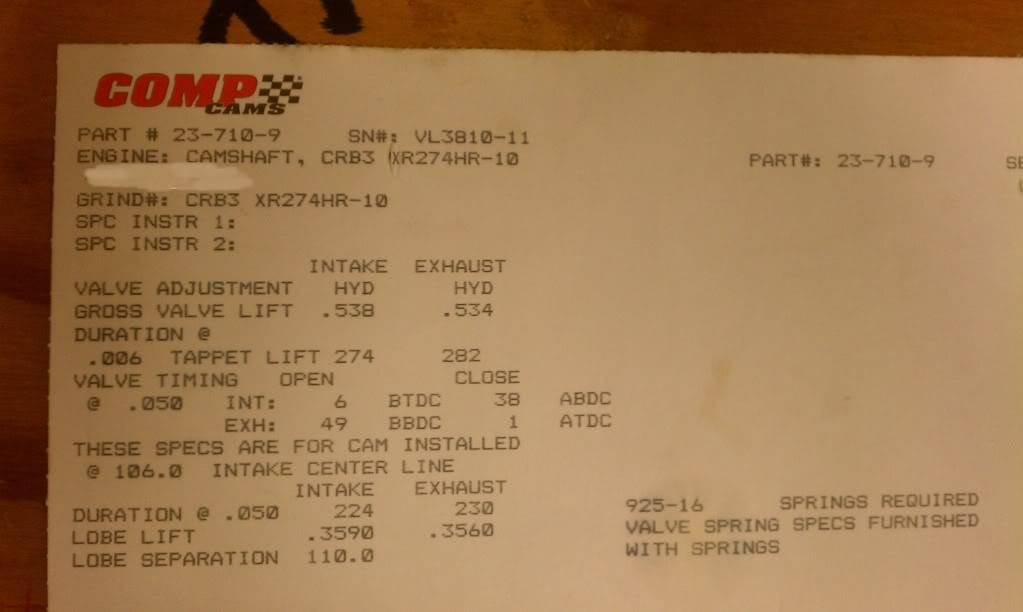

Yes cam is in the 224 /230 have not found the tag for the gears yet but feel like 355's - posi suregrip unit

Ok, thats a pretty mild cam. Good for your gears and a stock converter.
It sounds like youve got your mind made up on replacing the converter, which is fine, but I really dont think thats the problem.
Its your carb heatsoaking....Eddy's are notorious for doing it. Id say fix that before moving onto anything else.
Just my 2 cents.
