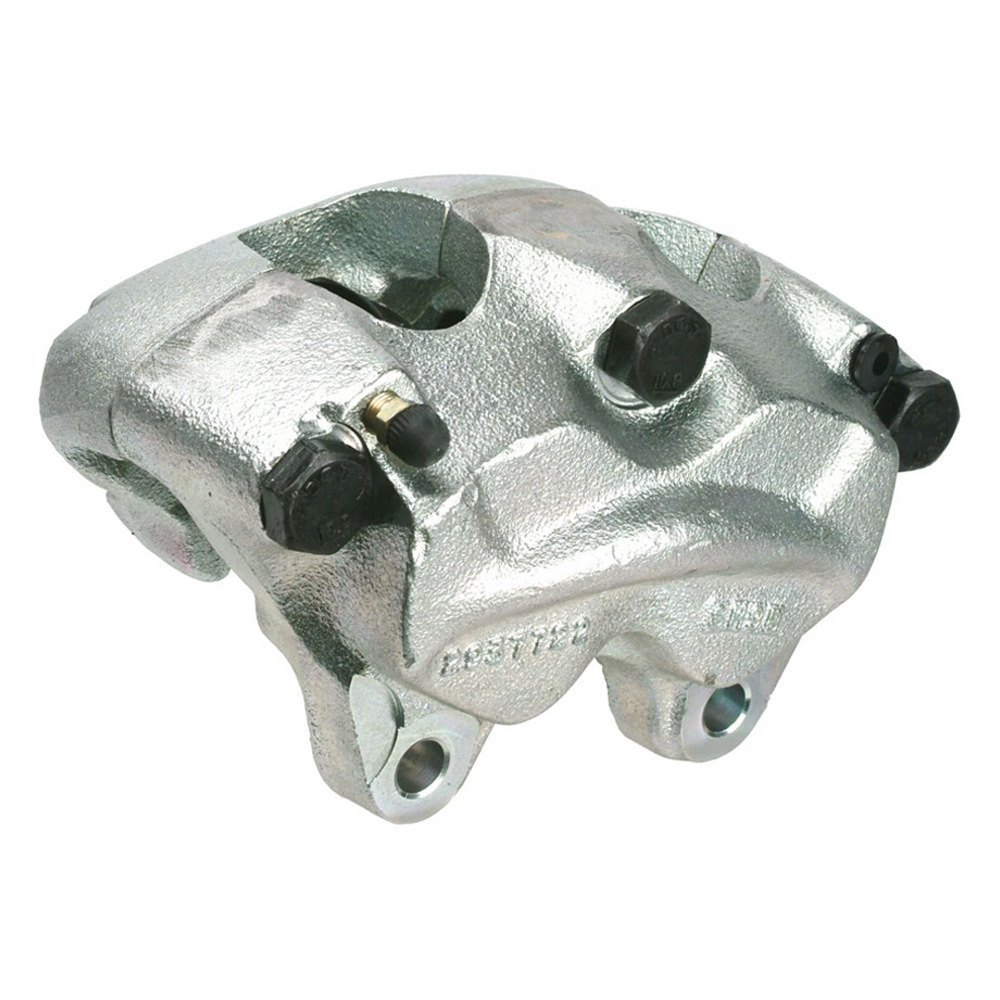

Well, last year the offshore Cardone replacements were $100 but they seem to have dried up now.
Are those cardone 4 piston calipers any good?? I need a pair and know where a pair are unused.
Those Cardone's are as good as your going to get, in this day and age.
If you know where are pair of them are, i think you'd better get them, while you can.
