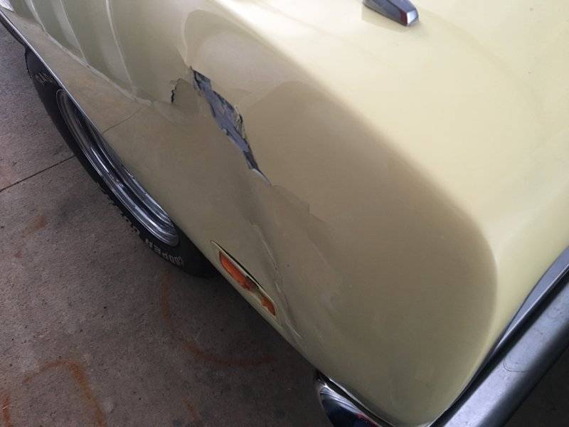

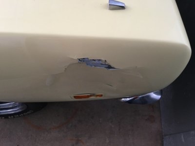

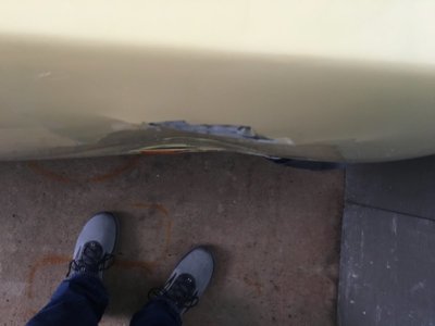

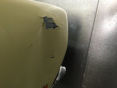

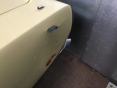

It was supposed to be a beautiful day in Pittsburgh Friday so I decided to take my 1969 Coronet R/T to work. I was backing out of my garage, which I must have done a couple million times, and for some turned the wheel to the left. I heard the terrible, ominous sound of metal on metal and hoped for the best. I got out and it was not good. Now, should I have the shop that did the restoration on it five years ago beat out the metal and repaint the fender, or buy a good used one to replace? I get angry when a fly sneezes on my car, so this is driving me crazy. Thanks for the advice.

Look like a 6 hours dent to me. No way I would replace the fender. Hopefully it’s base/clear then the color can be blended within the fender. If you get a different fender, gotta do the gaps and blend the color into the hood/cowl and door.
It is single stage paint. The hood and the driver side door are bondo queens so I have a doors and a hood in my warehouse to transplant when I get it done again in a few years. The quarters are reproduction so they are in better shape then the rest of the metal. Nobody makes Coronet fenders so I am stuck with mine or used ones. Hopefully, it will not be to much money to repair. I heard single stage paint is hard to color match the older, faded paint.
Get it fixed and blend out the color with in the fender.. should be a easy fix..
I also think thats with in a 1K repair with paint.
A good experienced painter can do it fairly easily. The fender is getting painted either way and the dent will be easier to get corrected than starting all over with another fender.
Sorry to see that also, Go back to the original shop you used, they know what they put on it for paint, Tint brands, mix, ect, or if they bought paint already mixed they know what brand ect.
With the live in the garage life style these cars have these days paint fade on a single stage will not be a issue. I would paint the fender then buff the door going lighter with the buffer and compound on the way to the B pillar, buff the hood and see what it looks like.
That pale yellow is going to be pretty forgiving as long as they do everything the same as in the past, sealer brand and color also.
